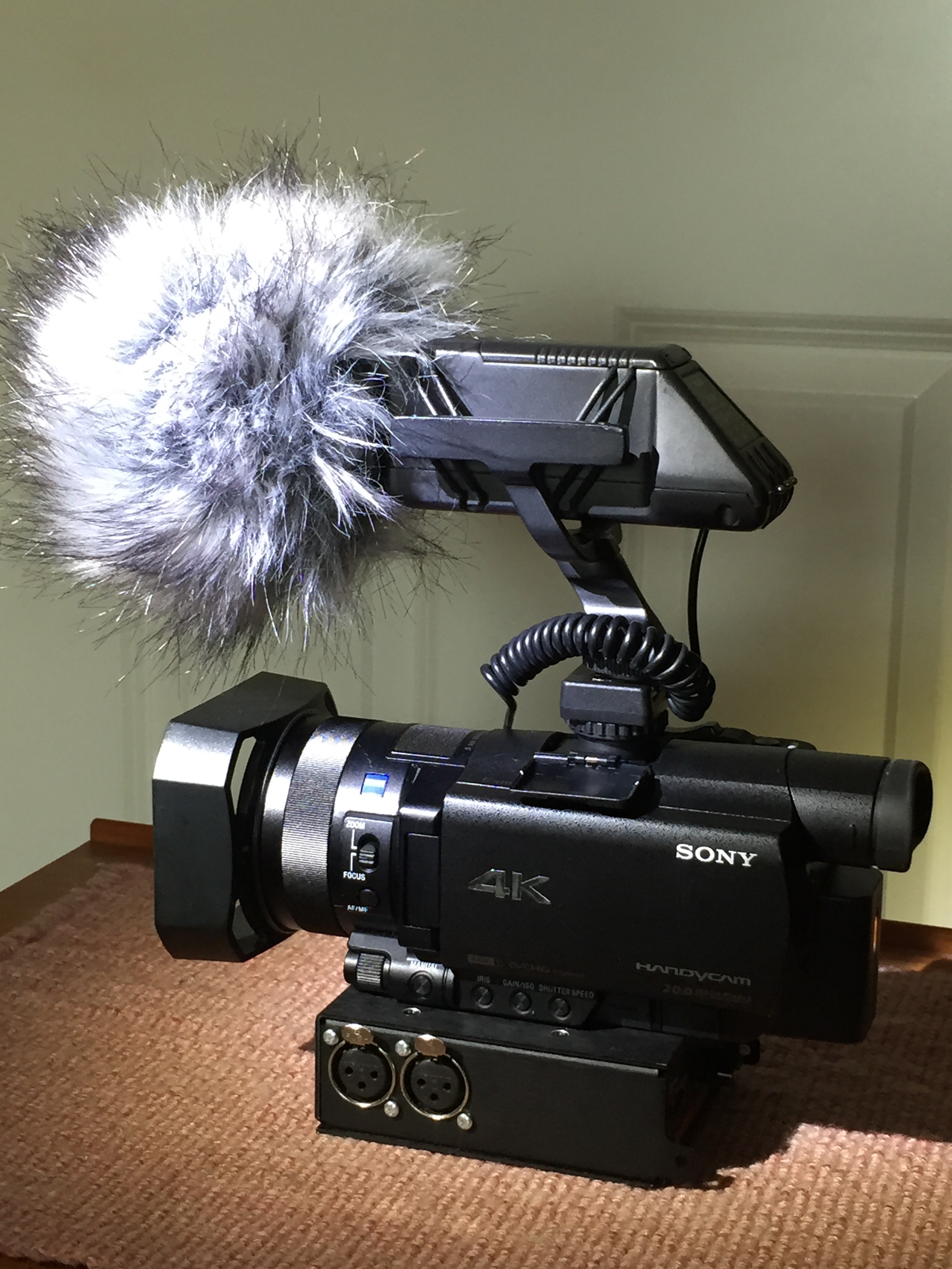

For something that meets your basic requirements check out the JuicedLink preamps.
Originally Posted by Peter Rush View Post
Hi all - what are you folks using for recording with XLR mics on your DSLRs? I'm looking for something that will give me phantom power and a true left/right separation but also something not too heavy for a hand held rig.
They have very good signal to noise and if budget is any consideration there are some well under your price floor on eBay. The link is to the CX211:
http://www.dvinfo.net/forum/members/...-controls.html
For size comparison, here is one on an FDR-AX100 with a Røde mic (not using the pre though):
