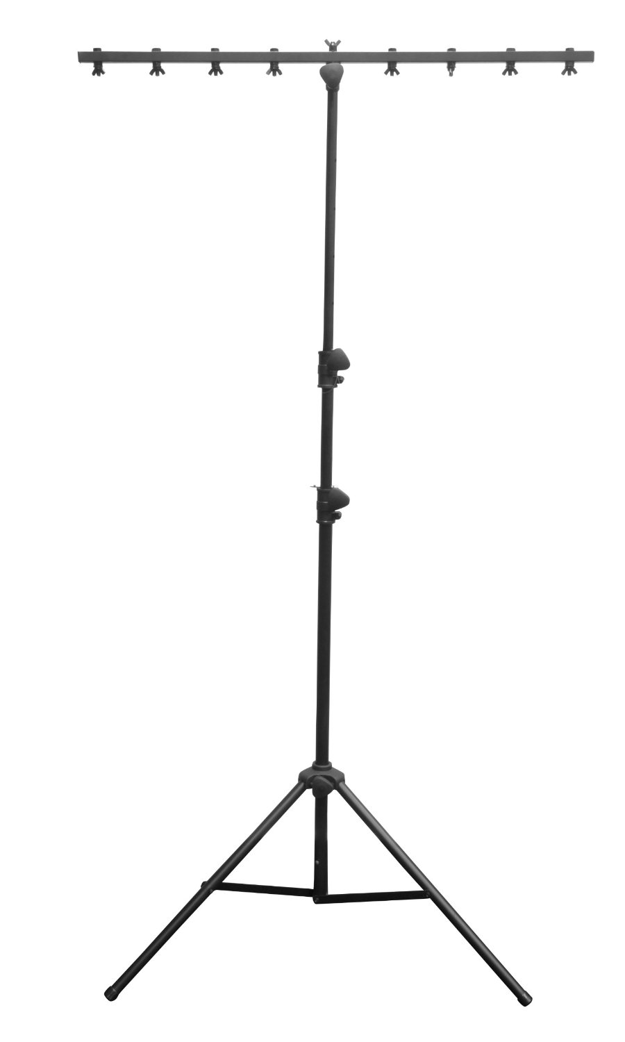

Clive, I find lights on 2 corners of the dance floor is best. Often the DJ will have his own lights and so its the opposite side that becomes a problem. When I DJ, or if I'm doing video and the light is crap, I have wireless/battery powered lights I can put up (picture below) that can fill with white light. No dimmer, but I can point it at the ceiling instead, if I want, and they don't have cords, and are easy to move to where ever I want them.
As for putting your lights up, simply pick up a DJ version of a light stand and maybe a t-bar. You'll need an O-clamp to attach the lights to the stand.
Ultimate Stand is a nice brand.
Just make sure its a light tripod NOT a speaker stand. The speaker stand will usually only go 2 meters high.
A T-bar will be a little bar, less than 1 meter long, that can go horizontally on top of the stand so you can easily mount both lights onto one.
Make sure the O-Clamp is the same size as the T-bar, which is the same as the light stand. In the U.S. the standard is 1.5 inch or 38mm (outer diameter pipe). The confusion comes from that speakers use a 35mm pipe to set on.
