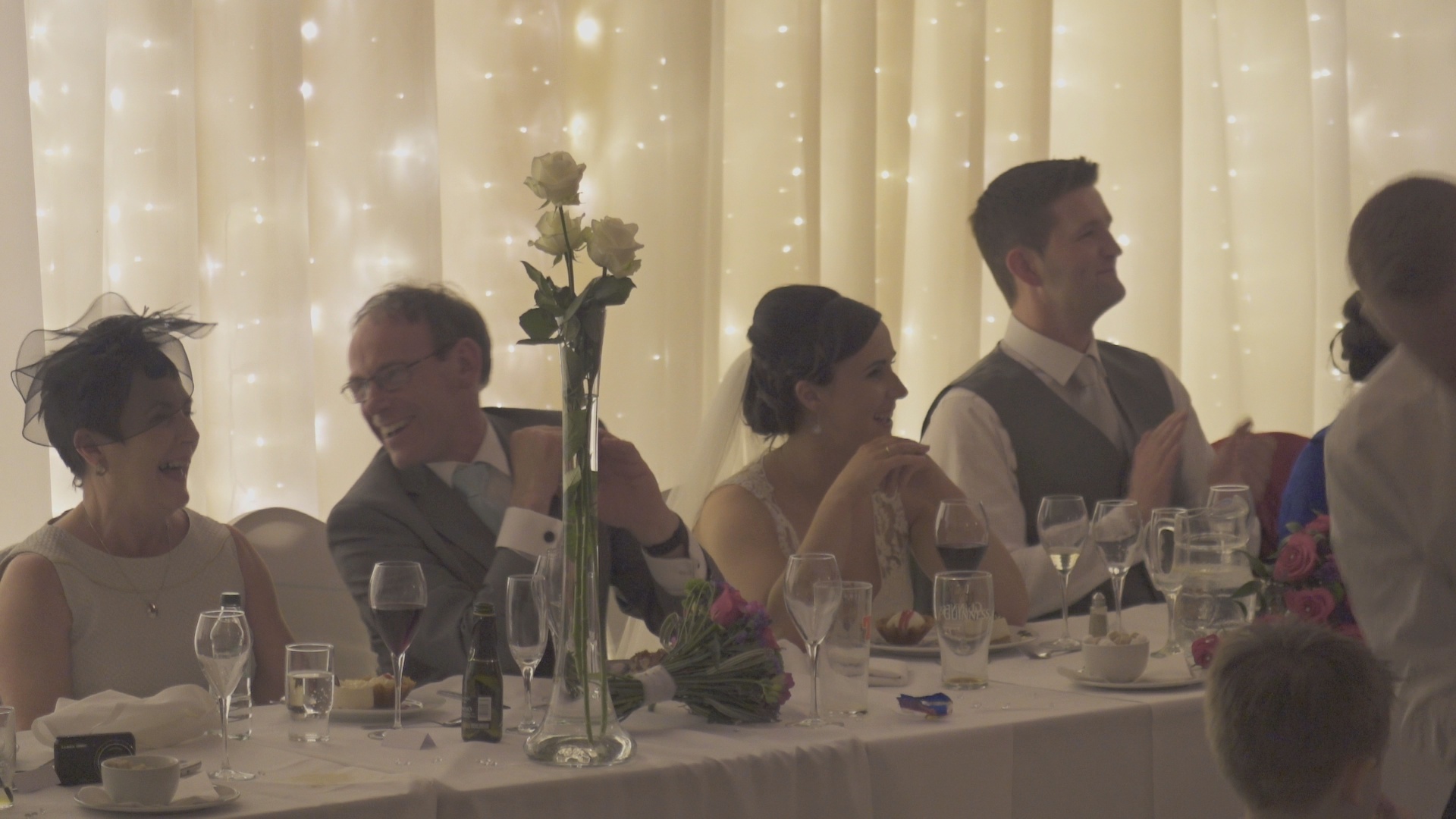

There was a surprised singing event happening during the meal at a wedding yesterday. I had to be ready and didn't know exactly when it would kick off. I would be operating a gimbal around the room but need a reaction shot of the B&G and a safety wide shot of the floor. I was expecting the venue to raise the lights (which they didn't in the end). But this dictated my need to use auto ISO.
Sadly however, as you can see the blasted fairylight wall meant this camera and my other wide camera underexposed the foreground.
I'm actually surprised how much I can pull back in post but it has added a considerable bit of noise (not to the point the client would be annoyed).
Any advice on how to treat scenarios like this where can't check settings until the lights are raised, and that might be too late to be running around?

Hi Clive
Surely even in full auto your camera has an ev correction?? On my Panny's I can instantly dial in up to 3 stops over or under so in backlit situations usually just going one stop over helps a lot to get the people exposed right in auto but of course it tends to blow out the background!! I'd rather have the guests correctly exposed and the fairy light curtain a bit washed out. I had a stinker last week where the venue had ceiling to floor windows behind the bridal table. Sadly venues don't think about us when they set up tables!!
I have no clue about correcting a backlit imagein other NLE's but in Sony Vegas what helps a lot is inverting the image (blacks to whites) first and then using a colour corrector to get the front back balance better and then finally invert again to bring it back to normal ...it's a well know plug-in chain usage ... invert - correct - invert

Thanks Chris, I'd not heard of that method before - I'll take a look!
As for the EV, I had thought about that, but like I said I expected the hotel to raise the lights again, so +3 EV might have overexposed teh foreground in auto had I it set that way! Turns out they decided to do this part in near darkness for some reason anyway despite the speeches ten minutes earlier having the lights up for them!

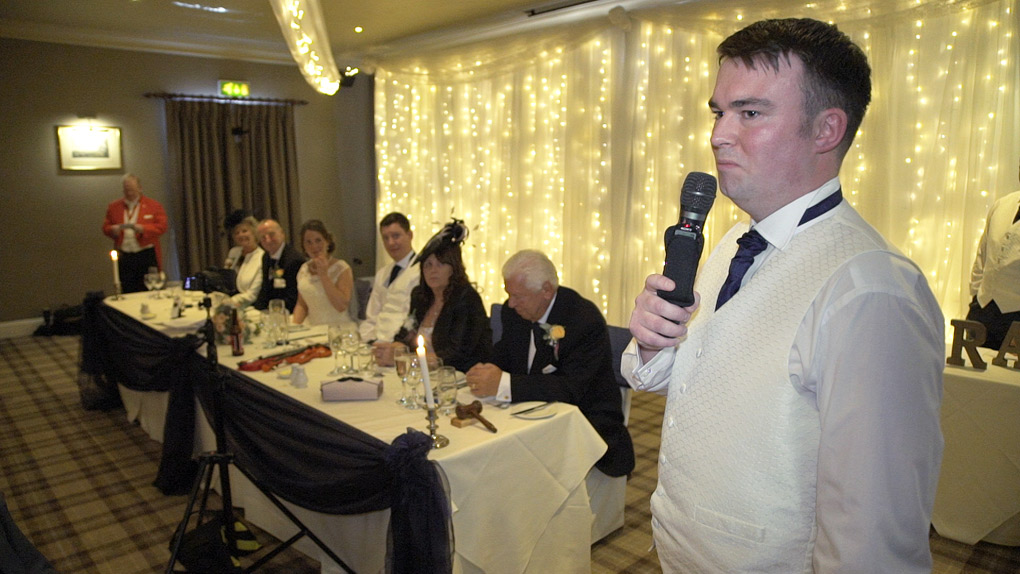

I hate them things - recently I knew the speakers were going to be fairly close to me so, even though it pained me, i used a light. The only lights in the room were the fairly lights, candles ad 2 picture lights. Backlit top tables are horrible but pretty much common so I'm used to them - Marquees in bright sunshine are the worst.
The most difficult lighting I find is dark bars with bright downlighters - it's almost impossible to expose so as not to blow out the tops of people's heads/faces without rendering the rest of the scene completely underexposed

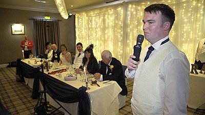

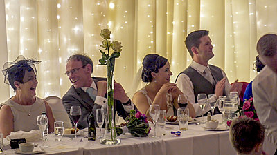

It is nearly impossible to compensate for strong backlighting without overpowering it with a lot of front fill lighting... nearly impossible in a typical wedding reception situation.
We have had some luck in post-production with a combination of filters (shadow/highlights, curves, and noise-reduction) in Premiere Pro and After Effects.
We also have some complicated techniques for severe problems.
Jim
