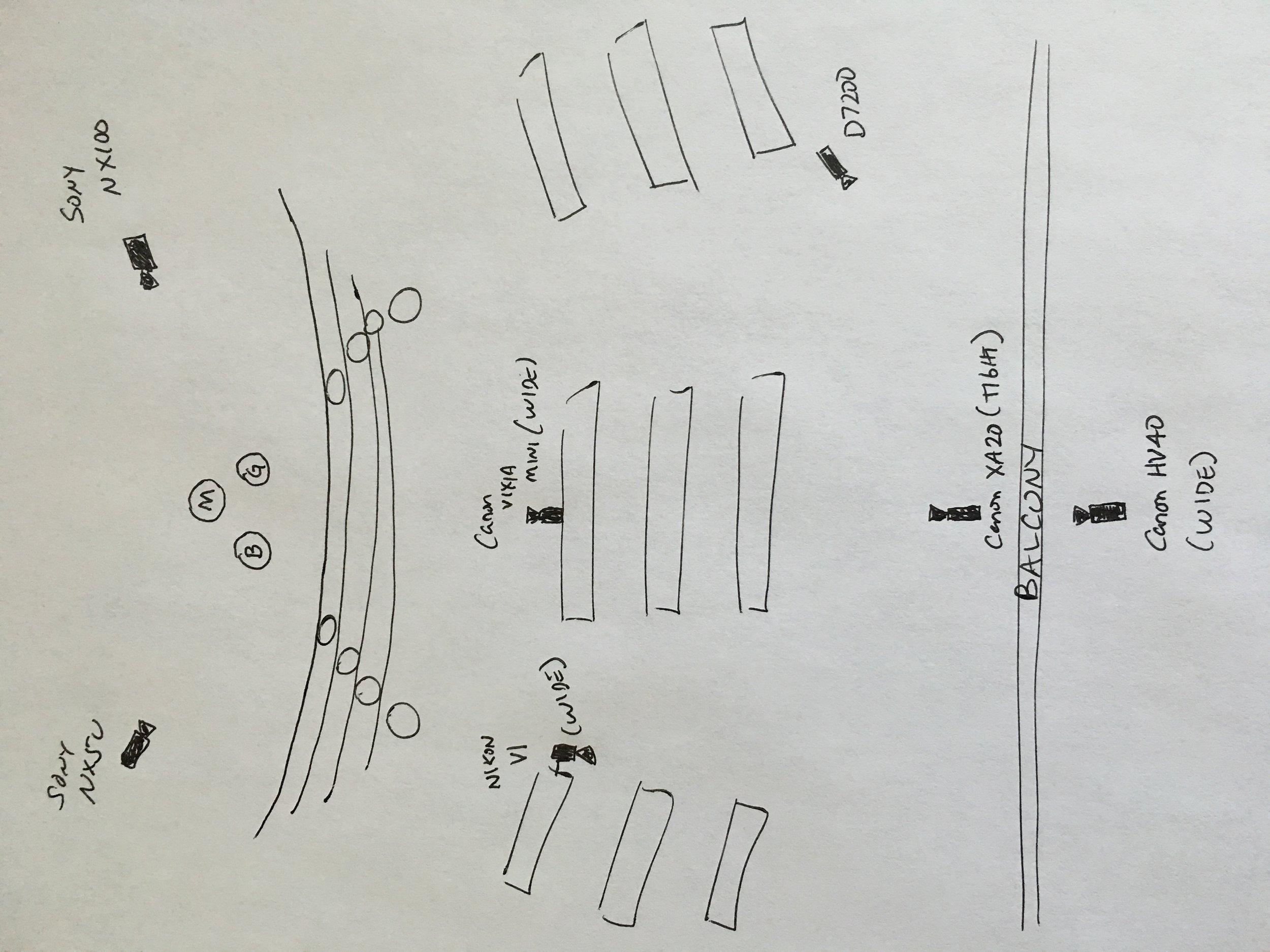

The last one I did was in Texas alone.
Attached is how I set up all the unmanned cameras.
I had a D750 with 70-200 on a monopod and was roaming.
This was a at mega church and a wedding party of about 15 people.
For me, it's more about safety in terms of camera, card, or battery failure etc.
