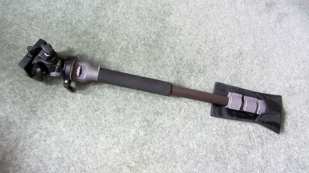

Well I'm still rocking the Steadicam Merlin so I'm very much behind the times but for me I only use it for a small part of the day, as a solo shooter I tend to play it safe! The rest of the time I use my monopod tucked into a Manfrotto belt pouch and I can get rock steady shots - way better than hand held or shoulder mount. Also I can perform a few limited pans and tilts (I use a manfrotto tilt head and keep the tilt loose) - I've only started to use this technique this year but it's made a massive difference to the way I film and saved me a lot of back ache in the process.
It's a pretty cheap Libec monopod (my Manfrotto ones are too long) with a Manfrottoo #200 tilt head and QR base - works a treat for steady shots! While not exactly a technique - a bit of kit not to be overlooked

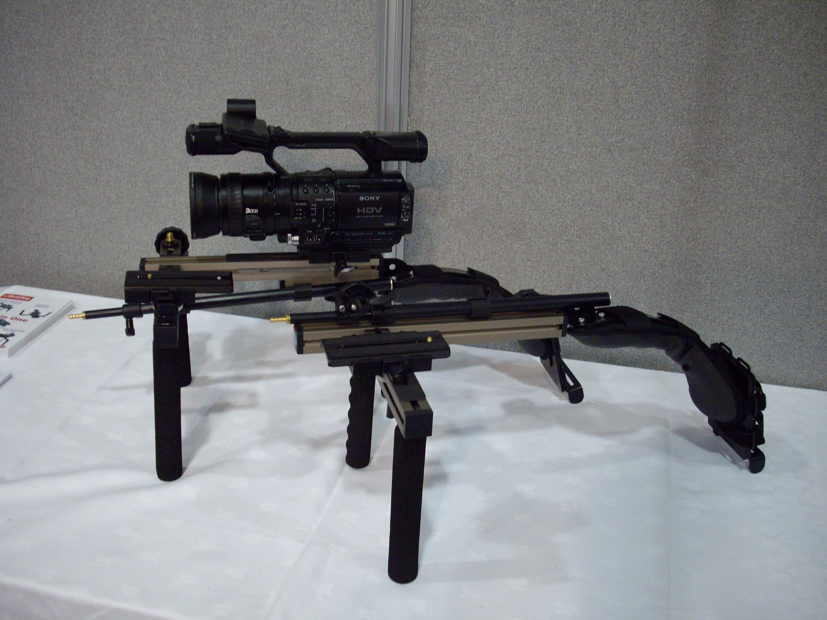

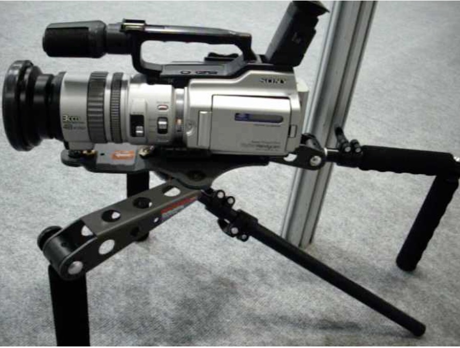

Old August 9th, 2016, 02:05 PM   #45
Join Date: Jul 2003
Location: Leeds, UK
Posts: 660
Images: 10
Re: Best shooting technique for hand held video
Originally Posted by Nigel Barker View Post
AFAIK the DVTEC Multirig was the first rig to offer the sprung rod & belt support
Actually the DVRig Pro and ProHD came out well before the Multi-Rig, and they both had telescopic springs.
I own all three and I helping Danny from DVTek at a few trade shows in the UK back in 2007.
I took along my VX2000 and my shiny new Sony Z1!
Danny also still makes an ENG-Rig designed to simply support the front end of large shoulder mount cameras.
AFAIK he invented all this stuff himself, and it's a shame his designs have all been ripped off.
The MultiRig Pro has a tilt mechanism, so you can simply twist the camera up and down without bending the spring section. It was perfect for the Z1 weight range, and isn't too bad for modern DSLRs. I still have all three rigs and occasional use them for this purpose.
The Multi-Rig is a lovely bit of kit. You can arrange the arms in a number of ways to suit your camera layout and shooting style, and can have a QR plate mounted underneath.
The pictures show my Z1 on the DVRig ProHD, and a DVRig Pro next to it.
My VX200 on the MultiRig.
Also Danny's splendid Moustache (long before November) at the IOV show in 2007.
Best shooting technique for hand held video-imgp0078.jpg   Best shooting technique for hand held video-imgp0085.jpg
