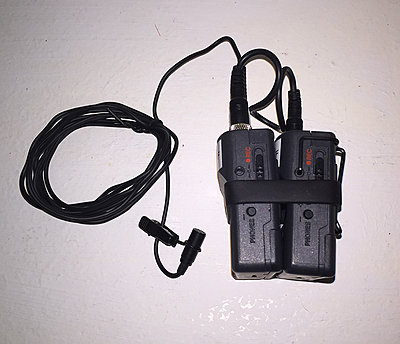

Tascam DR10CS/DR10L combo for ceremonies
I’ve tried quite a few audio setups for miking the groom and while each of them have worked they have all had issues (interference, non-locking mic jack, bulky, etc). This past year I started using a combination of two Tascam DR10CS recorders that has by far been the best that I have found. I’ve got a lav plugged into one of them and the audio passes through to the second one. Each recorder has a safety track that’s set to -12db which gives me four separate tracks of audio to work with in post (each track is set to a different volume level). I set the gain on the first recorder to HIGH and the second recorder is set to MID and since each track has its own safety track it’s very unlikely that the groom will be too loud for both the safety tracks (I first tried using just one of these but there were a couple times when the groom’s audio clipped the safety track which is whey I combine two of them together).
Since the Tascams record to micro SD cards, there’s no need for wireless transmission so the audio quality is much better than my Sennhesier G3 used to be. They are very small and each have a locking jack for the lav which prevents the groom from accidentally pulling it out of the socket. I own four of these recorders (I use two on the officiant as well) and it’s made my job MUCH easier.
I purchased all of mine from Pink Noise and Andertons which are in the UK and they arrive in Virginia within a week. Since I’ve purchased mine, Tascam has released an American version called the DR10L which does not have the passthrough but would work just fine as the second recorder (plus it comes with a lav which is not the case with the DR10CS). Overall I feel like this is a pretty amazing solution for audio that can be obtained for around $400 if you purchase one DR10CS and one DR10L. If you have any questions about the setup let me know as I felt like it was worth sharing since audio can be pretty difficult to get right during the ceremony.

Great set up! As I understand you are using one lav that feeds into 2 recorders? Why do you not use 2 lav's that go to their own recorder for safety? So you could pin 2 lav's on the groom, I have had a lavalier fail on me in the middle of the ceremony last year, your solution would prevent that from happening but only if there are 2 separate lav's.
Is your dual set up also not too bulky? I can imagine when it goes into the inside jacket pocket that you would see a bulge in the jacket?

OK, just googled the Tascam DR10-CS and it looks like a totally different recorder from the ones in your photo? https://www.amazon.co.uk/gp/product/...?ie=UTF8&psc=1
Two of those would be pretty tricky to fit in the Groom's pocket. Have you got the right model number?

On the photo you see the recorders from the side, not front.

Ah yes, that's makes sense, but looks like a pretty bulky package with two back to back.
It does semi a bit of overkill, and I agree with Noah that if you feel it necessary to have 4 levels of audio for each person, then a double lav would add another layer of protection.

Noa, that's a good point and I have used two lavs in certain situations (i.e. Outdoor weddings with lots of wind). I usually use this setup just to save me from having to run two mics but it's certainly not a bad idea to use two mics considering that lavs can have issues. I haven't found the setup to be bulky since the recorders are so tiny. It's hard to tell from the photo but they're actually very small so even with two of them attached to each other it's still quite unobtrusive and lightweight (I think it weighs less than my G3 transmitter).
Roger, I also like to keep things pretty simple which is why I've stopped using my Sennheiser G3 and switched to these. I think of your system works for you then stick with it, but I know several people who have used a voice recorder or Zoom H1 with a lav and been disappointed so these recorders seem like a good alternative (even if you just use one of them).

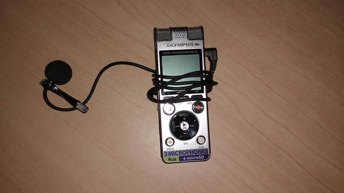

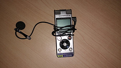

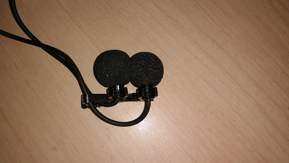

I have also been going the double-mic route. My Olympus recorders are quite slim (0.6" Depth), so putting 2 of them in a groom's inside jacket pocket doesn't add too much bulk. When I use two mics, I'll use a lav clip I modified to hold both of them, so we don't need to see another clip.
My lapel mic is a cheap Azden with a right angle connector. With that connection and the excess cord wrapped around the recorder, it would be difficult to unplug it.
I haven't used wireless for weddings in over a decade. I think I was one of the first to use MiniDisc recorders back in the day when no one else was looking for alternatives. I never liked the occasional interference or static, even with the better brands. No audio is cleaner than that of a high quality hard-wired recorder at the source. And you don't get that evil look from the church lady when interference happens.
