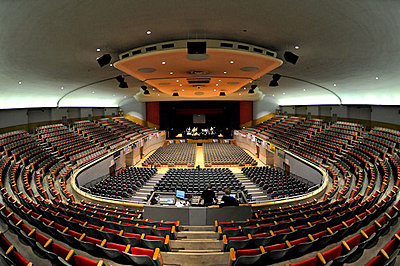

I am an amateur videographer who has been shooting local dance recitals for about 7 years using small Sony Handycams. The CX160 is right in front of the stage capturing closeups at an angle, the XR500 is manned by me from a platform just behind the left side floor seating, and the XR550 is fixed in the balcony just to the right of the sound booth (all of these locations can be visualized in the attached photo of the venue).
I get very good results with this setup each year but I still can't nail down the focusing of the fixed XR550 in the balcony. If I use auto focus it ends up taking a while to refocus when the lights go dim and then come back up. If I manually focus to infinity, it always seems like the dancers in the front of the stage are out of focus. Each year I try manually adjusting the focal length to a different setting but it always seems that the dancers in either the front or the back of the stage are out of focus.
Does anyone have any tips on how to get this camera to best focus on the entire depth of the stage (it's really not as far as it appears in the photo but I have no idea what is the actual distance)? Is it even possible?
