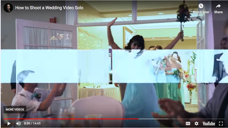

I’m thinking of filming an upcoming wedding with the Sony A7iii. I’ve been brushing up by watching some behind the scenes videos on Youtube.
A recent video I was watching I noticed some really bad flash banding (if that’s the right term) using the Sony A7. Is this a known issue or is there a shutter or frame rate setting that eliminates or minimizes this effect?
You can see what I’m talking about at the reception entrance 8:50

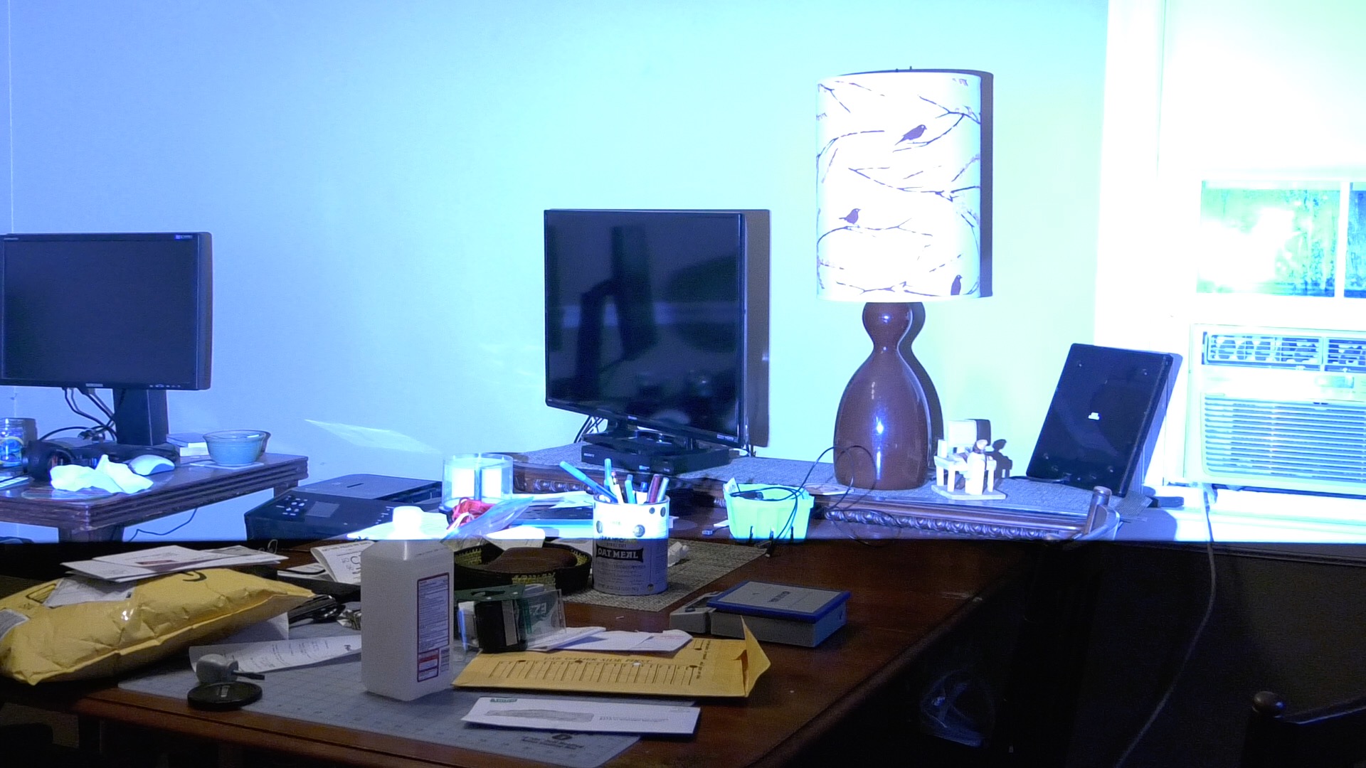

Re: Flash Banding
If the whole frame flashed white it look more natural than those weird white bars. I don't remember seeing them on my Canon 70/80d

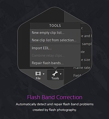

Probably the least painful and quickest solution to flash banding correction is to use Sony's "Catalyst Browse" which you can download and then use its Flash Band Correction tool. I haven't used it in Catalyst Browse but I have used it in Sony's older Content Browser software and it did a surprisingly decent job. Catalyst Browse is a free tool so maybe give it ago. Otherwise there are a number of Flash Band plugins around though don't have any experience with them.
Chris Young
Sydney
https://www.sonycreativesoftware.com/catalystbrowse

It occurred to me I have a flash so I could test my current cameras out. To my surprise both my Canon 70d DSLR (aps c sensor) and Panasonic UX90 camcorder (1" sensor) exhibited similar flash banding, although they seem more natural because the banding takes up most of the frame. I'm guessing the banding is narrower on the A7 because it can't capture as much due to the resolution and sensor size.
I saw this video which had a good explanation.
