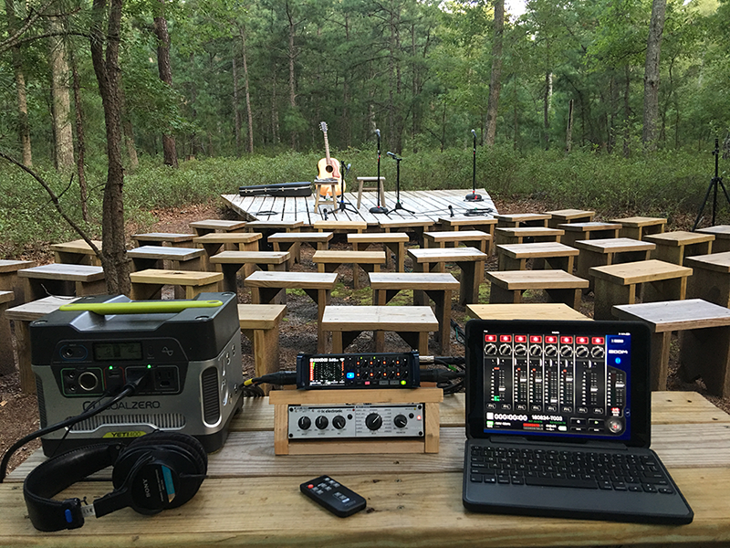

Have had a GoalZero Yeti 400 for several years now and it's great - approximatley 400 watt-hours, so (theoretically it would run a 100 watt load for 4 hours. Got mine on sale at REI.
https://www.goalzero.com/shop/last-c...power-station/
They have all kinds of other portable power packs, with clean sine-wave power. You can also connect solar panels and daisy-chain the larger power packs (like mine)
https://www.goalzero.com/shop/portable-power/
I use it primarily for our fun family "concerts" at a little stage out in the woods on my property. The Yeti 400 runs my Zoom F8, with 6 mics, effects processor, iPad and a pair of small stage monitors for over 4 hours. Not the cheapest solution, but well-made with a user-replaceable battery. I have had a couple inexpensive units (more like the one in your link) and they only lasted a few years, were discontinued by then and not easily taken apart to replace the battery.
