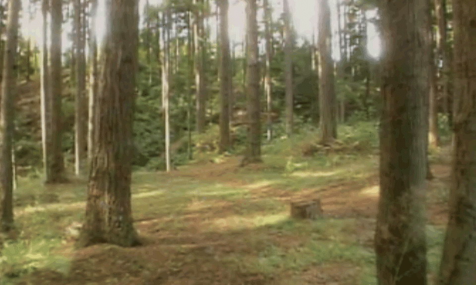

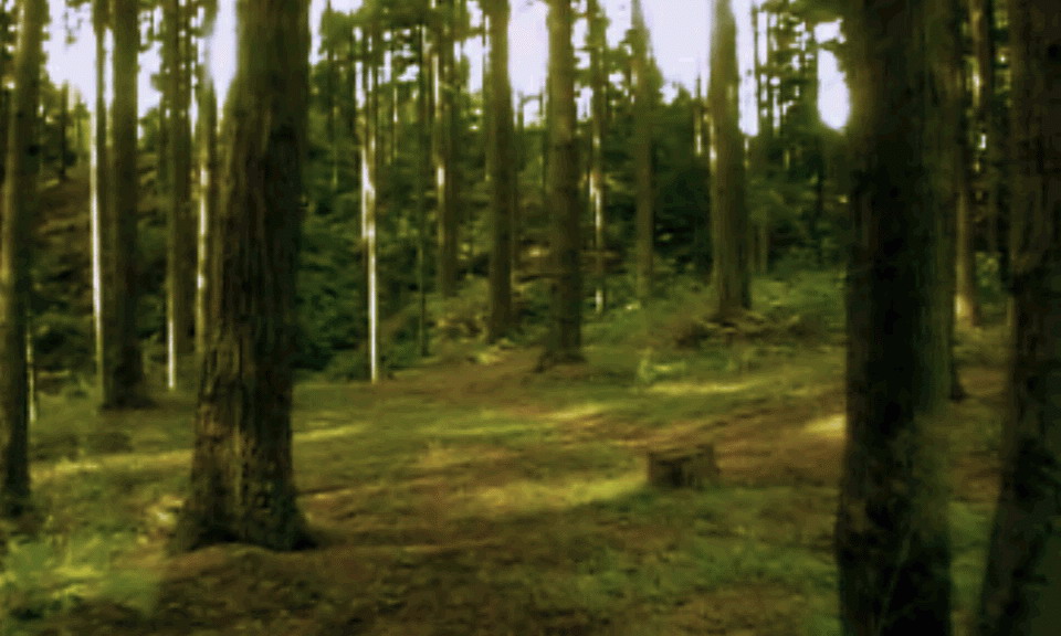

I attached 2 screen shots to show the result of such a color grading.
Left image is the original shot. Right image is colorgraded.
In this example the values were:
Shadow Red: -20
Shadow Green: 60
Shadow Blue: -100
Midtone Red: 30
Midtone Green: 0
Midtone Blue: -90
Highlight Red: -50
Highlight Green: -80
Highlight Blue: 70
