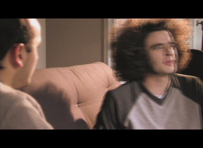

Alright, so I made 60i clones of all the 24pAclips I used in the project, dropped 'em in the 60i timeline. after doing a test to verify it looked right in a 60i project.
My editor friend tells me that it'll never be completely smooth when doing 24p to 60i (meaning it'll never look as good as it did when it was 24p footage during movement) so for now I've lowered my expectations.
Now I have new issue. On all clips in my final timeline, I'm getting these "half fields" when the interlaced frames show up in the 60i version of the clip. What I mean by half field is a field that's got the lines doubly spaced apart. The full field doesn't look so bad, but these half fields look horrible. . .no way I can let 'em go. The funny thing is, if I copy the clip out of my timeline and paste it in an empty project, also 60i, with identical settings, I don't get this issue. I've tried, in my project timeline, removing FX, etc, still getting it. It's there when I render the clip too, not just in the timeline. If I add FX to the pasted clip in the empty project, still looks normal. I don't know what's causing it.
Here's a still from the timeline, FX and all, with a "half field" shown. The only thing I've known to cause this is when cropping/zooming a clip and outputting interlaced. This still's from an uncropped clip. (click on it to see at full rez)
