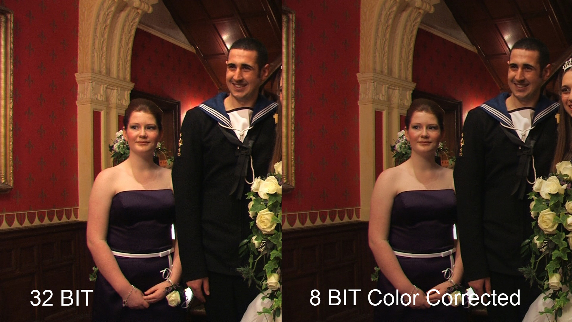

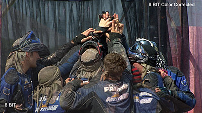

I mistakenly stumbled into this last night after setting my properties to 32bit instead of 8. Took 6hrs 3mins to render a 55min sequence of HD on a Quad Core with 4Gb of RAM. Once I sussed out what I had done, I had a look at the difference and was pretty surprised.
The "grey cast" that Joe mentions in his second post is plain to see in the Comparison 2 grab.
Did some digging and found this thread.
Decided to try some color correcting (Levels with some tiny tweeks to Input start and Gamma) to try and match the 8bit to the 32bit and got "close but no cigar". Seems to have a little less gloss and the whites don't "pop" as much.

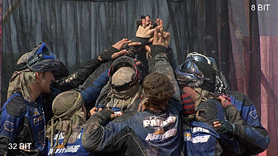

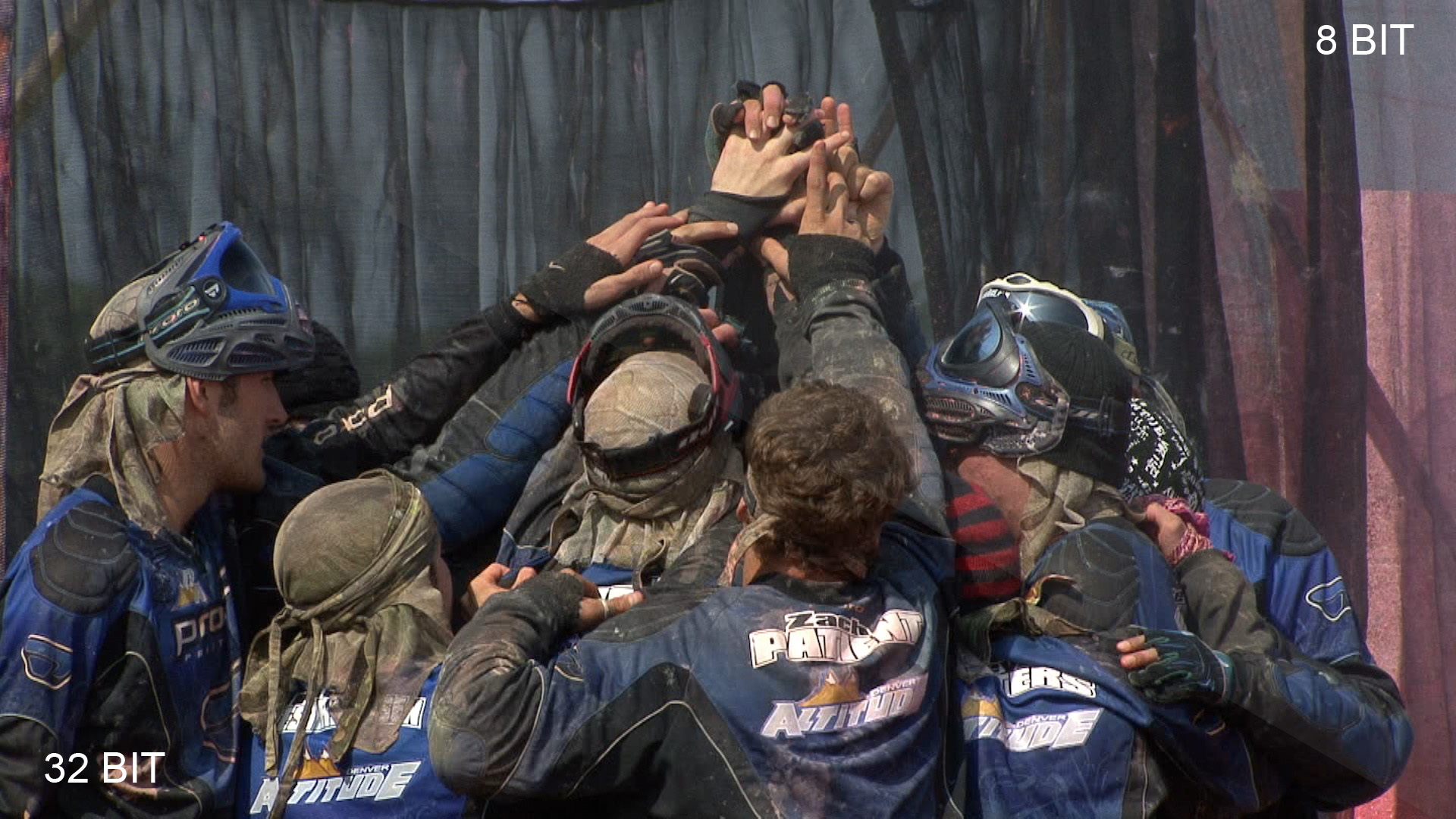

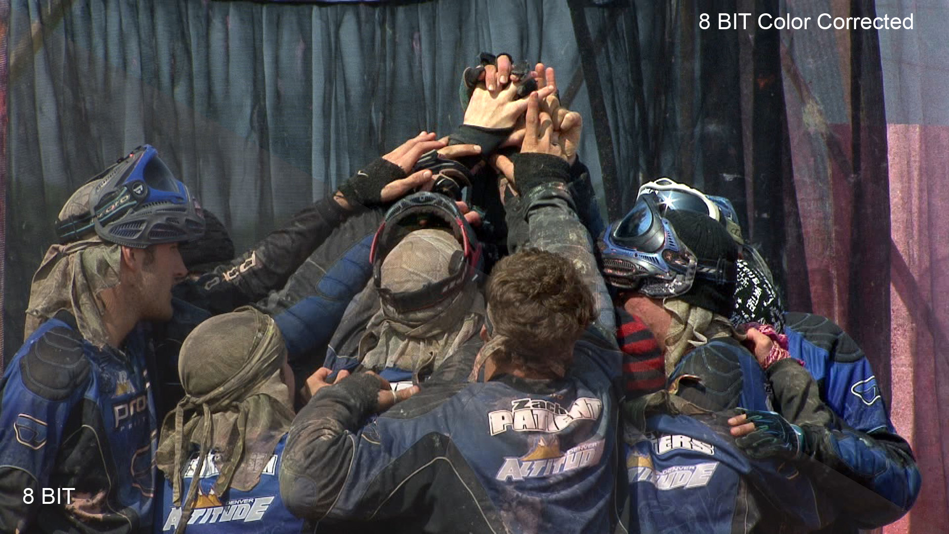

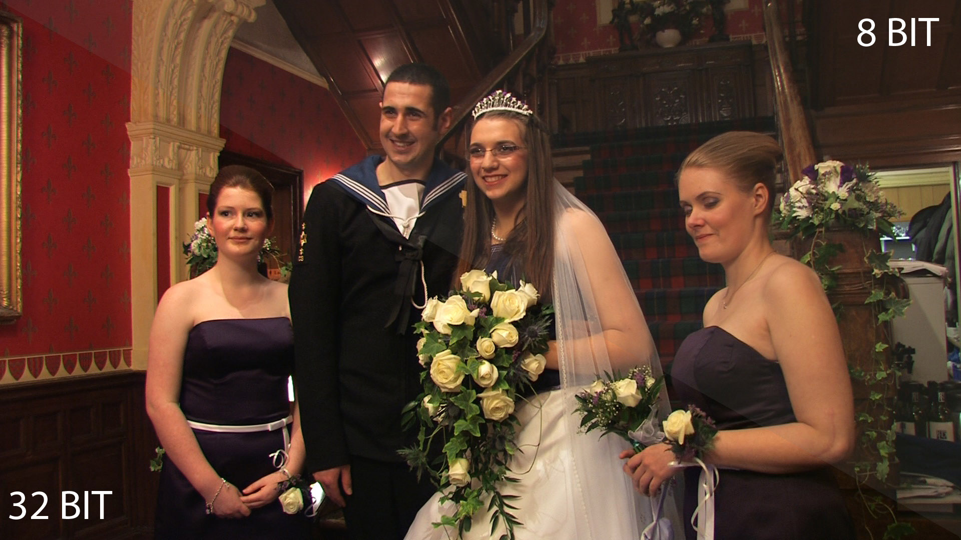

Just done a side by side of Joes pics as well for ease of viewing.
