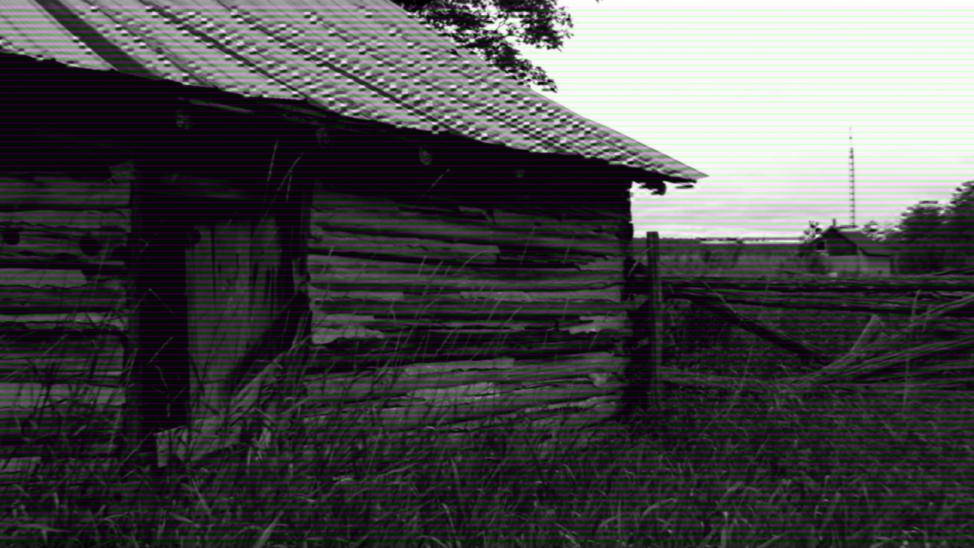

I've been fooling around with Vegas Pro 8 for a few days now (demo version). I finally tried a render of a short video clip with some effects (black and white, some contrast adjustment and the odd transition) and found that there is something very wrong. There are purple lines through the video and very blocky white artifacts happening on highlights in the video making the render useless. My source video is HDV from an XHA1 at 60i captured in Vegas 7.0d and brought into 8 as it's native m2t format. Within Vegas 8 the video looks right in the preview window but the resulting AVI 720-30p render is garbage.
Is this because it is the demo version instead of the full version?
I have attached a screen grab of the rendered video, has anyone else seen this happen in their renders with the full version of Pro 8? I wanted to test it out for a bit to see if I wanted to upgrade but I will not if this is a common problem/bug.

Try the Dynamic RAM preview at 0MB and reduce the rendering threads to 1. And/Or, render in HDV MPEG-2 instead of the Cineform VFW .avi

Jack, Setting my dynamic ram preview to 0 did not solve the problem, however rendering out as a MPEG2 file did generate a proper render, no purple lines or artifacts to be seen so I thank you for that suggestion.
Vegas 7 would have no issues with my original render options and would create an avi just fine, so I have to consider that Vegas Pro 8 has a pretty major bug rendering out AVI's right now. I'm sure they will get it fixed up in an update but would appreciate any other advice as to why an AVI will not render properly from 8 currently.

When you say it Vegas 9 won't render out an avi, do you understand that "avi" is just a generic name for many different codecs that fall under the "avi" umbrella. It IS significant to know which avi codec you're trying to render to. Your post implies that the specific codec is the Cineform codec. Be advised that there IS a bug in the way Vegas 8 accesses the appropriate cineform codec. IF this is your problem, the workaround is to go into your Vegas 8 folder and disable the CFHD.dll file. Disable it by renaming, moving or deleting it. I would recommend against deleting it, in case you want to restore the configuration in the future. This fix works only if you have a valid license for Cineform somewhere else on your machine.

Bill, sounds like this may be the fix, and sorry...your right I did not specify that it was a cineform AVI I was rendering to.

The CFHD.dll tweek did the trick. Renamed the extension in the Vegas 8 folder and rendered out as a cineform AVI with perfect results.

Looking at the image very closely, you have pink and green lines. The green are hard to see and make those parts look grey.
Pink and green are the extremes in the chroma part of the image. When both Cr and Cb are at their maximum, you get pink, when they are at their minimum, you get green. The most common reason to get both at max or min is because the encoder hasn't actually created any chroma information. So what you have is a luma image (the barn, that looks horribly similar to mine!) with unencode chroma.
The blocks on the diagonals of the tin roof look like incorrectly encoded DCT blocks for the luma. Based on my experience troubleshooing our own encoder, I'd say that the encoder you are using is making mistakes when there is a certain level of contrast in a given block (16 x 8 pixels).
Your image sample is 1920 x 1080 and your target format is 720p. I assume that the screen grab has been scaled up from 1280 x 720. This makes the width of the chroma bands (4 pixels) and the size of the luma blocks (16 x 8) more meaningful.
For the luma to be wrong in many parts and for the chroma to be hopelessly wrong suggests to me that either the decoder (required to do the editing) or the encoder are assuming the video is in a format different to what it really is. This might be a very slight difference in the header that tells the decoder/encoder to treat the data incorrectly. I don't think it can be completely off target, though, otherwise you'd probably get just complete random junk or an error.
