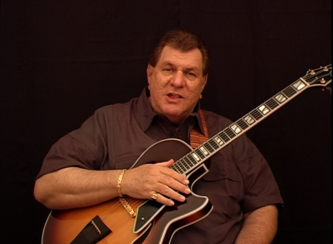

This is what I came up with. It looks good on the TV, but now it's really dark on my computer monitor. Should I just not worry about how it looks on the computer monitor?
I've also attached one avi frame (rename from .mov to .avi) from the orig. footage without any correction so you can see if I did a good job or not.
Bingo! You can't do accurate color assessments with the computer monitor. That's why the separate dedicated production monitor is important. A consumer set will be more helpful than a computer screen, but ultimately you should strive for a real production monitor with blue gun switch, etc. There have been a few good deals recently in the DVINFO classifieds.

"Bingo" as in I did it right? I know it's probably not perfect but it's not a hollywood epic either haha. I didn't mean worrying about doing color correction from the computer monitor, I meant the big difference in how it looks on the computer and the TV, i.e., if someone buys this DVD and watches it on his computer, it will be looking a lot darker unless he messes with his brightness controls, right? Did you see the avi frame too?
Mike, is that Robert Conti? It sure looks it.
