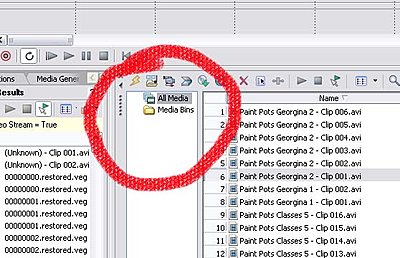

Here ya go - right click then select Search Media Bins to find the critaria selection Grazie is talking about. Very useful.
Ian Stark is offline   Reply With Quote

Ha! I see you found it already!
