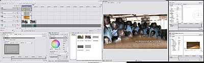

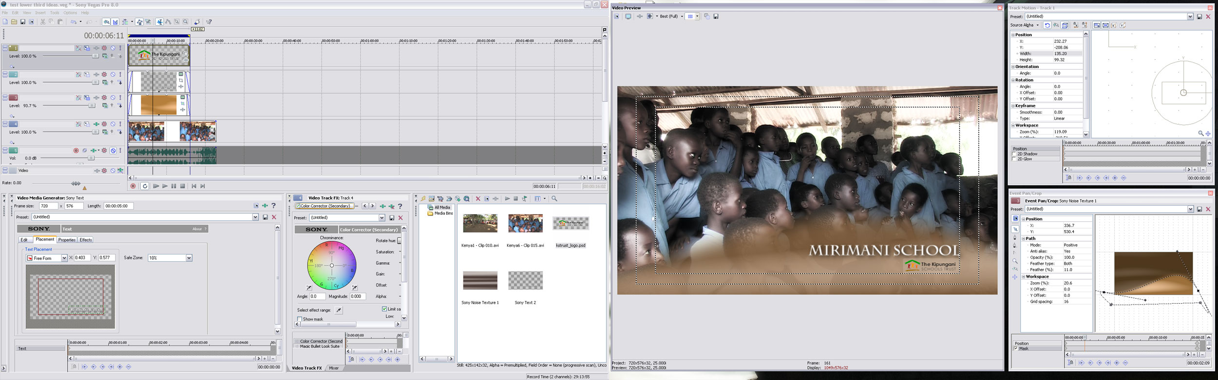

Similar to Don, except I run the preview in a window on the second screen so a) it doesn't disappear when passing through f/w to the production monitor and b) I also drag pan/crop and track motion windows there. Believe me, if I could have four screens, I would.
BIIIIIIG screenshot attached!
Ian . . .
