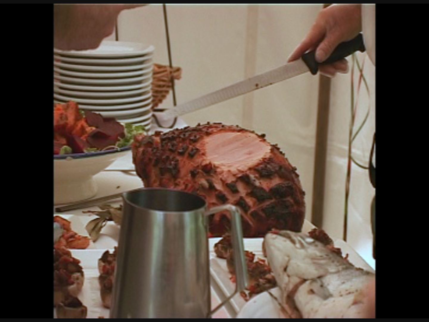

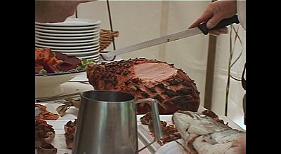

This is shot with a Sony PD170 and i forgot to white balance when i went inside this tent.
I have tried nurmous times to get the right feel for this but i going mad.
The inside of the tent is white, the plates are white.
There seems to be a cast over the picture but i cant work it out.
Can some one try and CC this and tell me how you did it?
I have used levels to bring the thing into range then i used the three wheel CC and sampled the walls, Curves to adjust the red cast.
Cheers
Simon

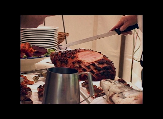

Here's my attempt. Used levels FX first, then Color Correction to white balance. Levels settings are: input start = .089; input end = .758; output start = 0; output end = .839; gamma = 1.00. On color corrector (3 wheels), they came out as follows: High = Angle 325.0, Magnitude 218.0; Low = Angle 312.5, Magnitude .344. Didn't mess with the mid's or any of the saturation, gain, gamma, etc., settings. Hope this helps a little.
Randy

Well . . Simon I got your JPG, viewed it and it looks fine? The tent is white. The meet looks sumptuous. What's the problem? I look at Randy's and it looks RED. The tent flaps look pinky - what IS going on?
When I looked at the VEG from David:
1] I don't get the media
2] I swap IN Simon's JPEG into David's Veg and it looks blue.
From what you say, Simon, it is as if Simon's (red) has been swapped to Randy's!
I have NO idea what is happening now!
And yes, I have again re-checked and rolled over both submissions and the reversal of "effects" is still evident.
Grazie

Its funny after a few days of not looking at it but i think your right Graham it has a slight blue cast over it.
My color TV monitor has died so i cant see this correctly and i wont trust my Samsung LCD to CC.
Thanks Graham and David for you input.
Cheers
Simon

The 2 jpegs in your first post-the onwe on the left looks a bit reddish but the one on the right looks pretty much spot on just viewing it on my computer monitor. To me whatever you did there would be right on about 99% of anything it got viewed on. If it were me, I would go with those settings.
Don

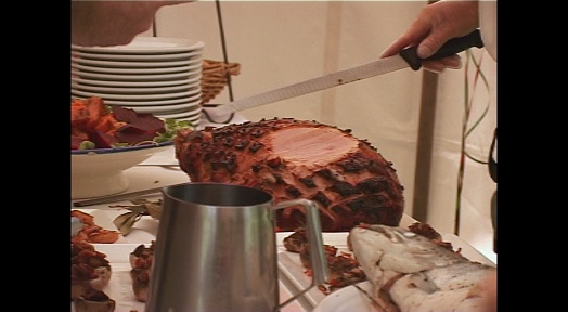

here's what I got when I white balanced in Edius...
