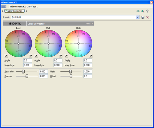

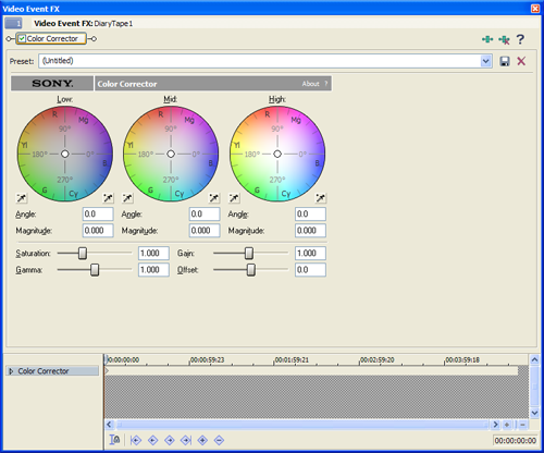

You probably hid it by accident. Move the mouse over the bottom part of the window. You should see a symbol with an arrow up and down and in the middle, two parallel lines (NOT just arrows up and down.. that will change the size of the window). Click and drag up.

The keyframe area is resizable. Yours is apparently resized to "nothing" right now. Move the mouse to the bottom of the dialog. As soon as it turns into an up/down arrow, click and drag upwards.

Screenshots... See the two lines at the bottom? Mouse between those two. Click and drag up.

Oh man!!!
Thank you so much guys! You guys really saved the day!
I thought it was something easy like this.
Again thank you both!!!
