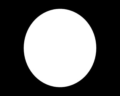

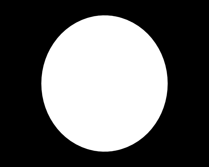

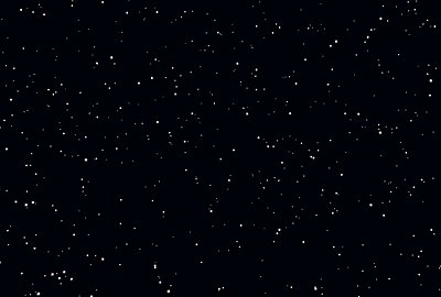

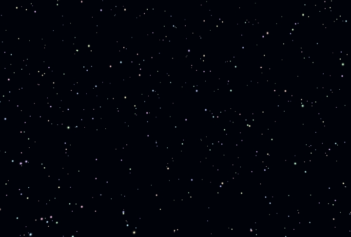

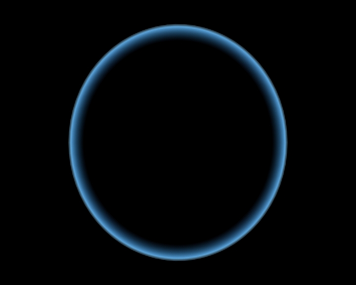

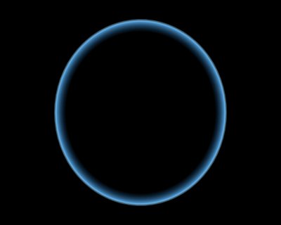

I have added these pics to show wht I am dealing with.
The video in addition is a full colour Earth globe on a black background

You could add an alpha channel to the globe file in something like Photoshop, and then save it as a .png so it retains the alpha information. you might have to invert the alpha or use as is when you import, it all depends upon how you create it.
You didn't post the earth jpg, but I gather there is black in in and that too is keying out when you key out the background black.

I went and used the circular cookie cutter which worked perfectly.
I will try various scenarios Bill but thanks for your help anyway.
Chromaing was just a little bit off because of the black part on the Earth.

Try this veg file (for VP8).
Replace the generated media with your animated Planet Earth.

Gilles, thank you, that is exactly what I was looking for. I note you have the ATMOS track set to "screen" I did not even try that.
Great Stuff
I can't believe the one major difference is applying the Mask Generator at Track level rather than event level. I don't know why it works but it does.
