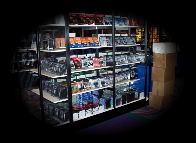

Here's another option. Try the Video Media Generator (FX), go to Sony Gradient, choose eliptical, and overlay that over your vid. Here's a sample with a still picture.
You can vary the edges by moving the numbered circles inside of the window of the gradient. There are several shapes. Hope this works for you.
