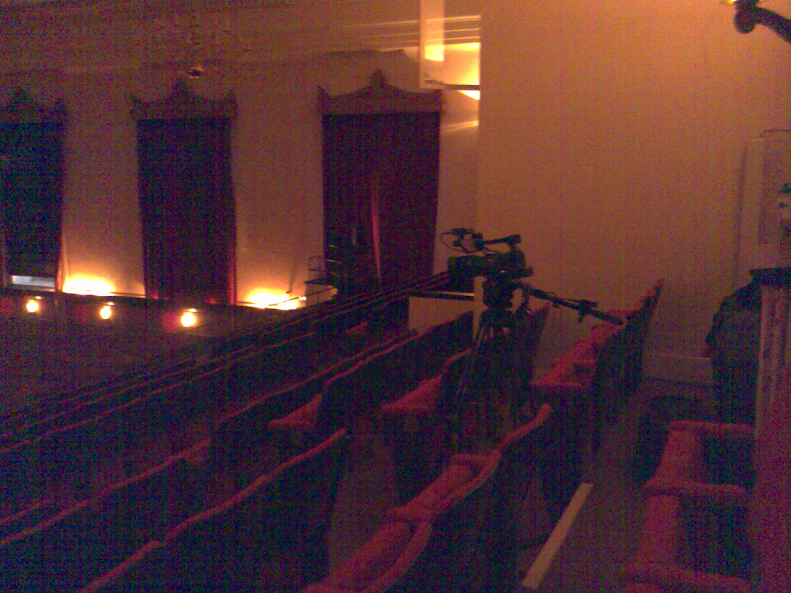

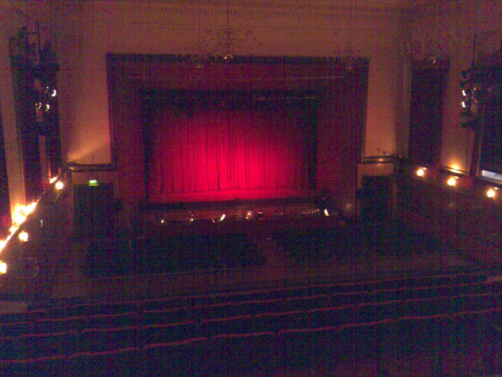

Mark,i was only on the same spot for the 1st night,the 2nd night i was upstairs on the balcony,i multicammed it all together after to make it look like 2 cams,i covered zooms by switching to the other cam/night in multicam editing. It was my first proper solo shoot. I ended up selling around 40 dvds,burnt,printed,boxed etc.
I had 4x8gig cards and finished the shoot with 4 mins left on the last card.
Here's a pic of how far away i was when i shot from upstairs.
Sorry the quality is crap,they were taken with my mobile phone.
