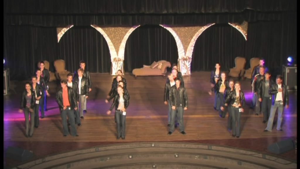

I edited a project in HDV and need to down convert to DVD Pal Widescreen, the problem, I'm getting envelopes on the left and right side of my DV footage. Tried everything I know, how can I solve this?

If you mean the stripes down the left and right side, I'm betting they won't be visible on a TV anyway. However, you might try checking "stretch to fill frame" when rendering and see if that helps.

If you have your project properties correctly configured for your target output... another thing I believe works is to go into the "Event Pan/Crop" for your clip(s), right click inside the dashed bounding rectangle, then choose "Match Output Aspect". But just be aware that you'll lose a little bit along the top/bottom of your clip. The downside to this technique is that you need to apply it to every clip in your project. The upside is that you have the ability to then re-position the pan/crop bounding box in case there is something along the top/bottom edge you want to keep. Not to mention that [I believe] you won't incur any distortion of the image that may be imposed by the "stretch to fill frame" method.

Vegas is very literal about maintaining the absolute correct aspect ratio when converting from one widescreen format to another. Ed's suggestion about using the "stretch to fill output frame" setting will eliminate the bars, however, your footage will then be wider than is correct. People will appear ever-so-slightly shorter and fatter than in reality.

I figured such a small amount of stretch (8 pixels) would not be noticeable. Now... stretch 4:3 to 16:9 :-)

Ed, I think your solution was perfectly valid and the only way to eliminate the micro-pillarboxing. It's highly unlikely that anyone would actually notice the stretch. I just wanted to point out that the result wouldn't be "nitpickingly" correct.
