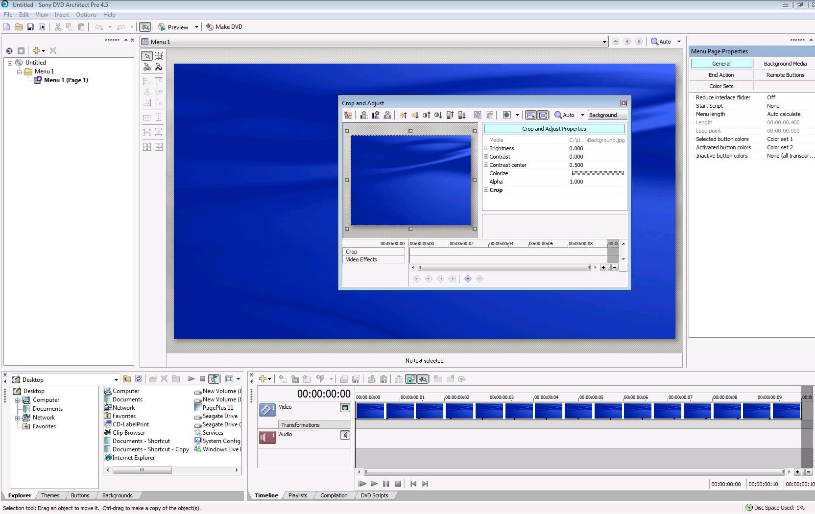

Indeed, right click on the actual menu page, the big blue one in the middle,a box then appears, (on the left in my screen), select "crop and adjust" and then another window opens, brightness and contrast (and other stuff) in in there.

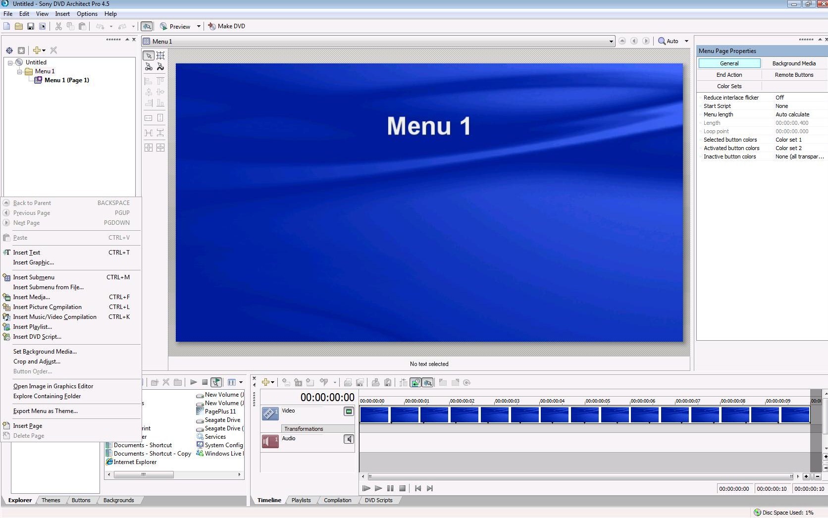

First right click in the middle of the screen, on the big blue part, then from the pop-up window select crop and adjust.
Brightness/Contrast in DVDA-dvda-screen-grab-1.jpg   Brightness/Contrast in DVDA-dvda-screengrab-2.jpg

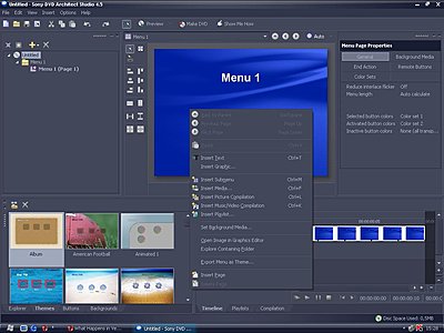

Now I see, Paul: in my version 4.5c of DVDA there is NOT such an option really!!! :(
Is there any possible way for it by a key combination from the keyboard?
Brightness/Contrast in DVDA-dvda.jpg

Plamen, are you using a "Movie Studio" version? The Movie Studio versions don't have as many features as the full/pro versions (but they don't cost as much either).
Yep... according to your snapshot it's a "Movie Studio" version.
