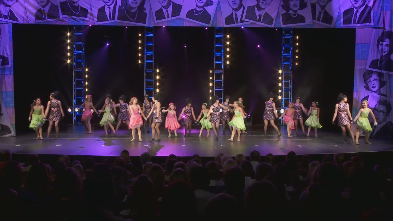

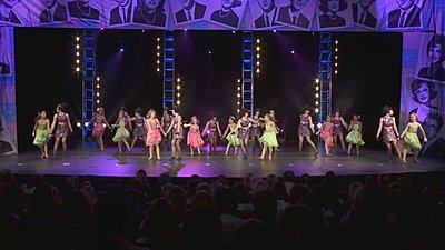

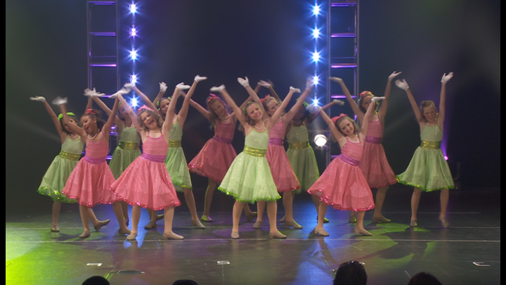

I think I get it now. The shots are too wide and include too much "other stuff" that's not important to her customers. I believe your client is telling you in lay terms - that she was expecting full body and medium shots of the dancers so that the parents of the event could clearly see their daughters and loved ones. (see the next post for examples from your video) The customers of the event are probably typical parents who are only interested in seeing their little darlings up close, shining in the lime light. Anything outside of that and they're not interested. I know if my daughter was in this event, that's what I would be expecting. Thankfully you used HD so you could try cropping the video, but you've lost a lot of that resolution because the dancers are so far back in the frame.
Next time a better setup might be two cameras:
Camera 1 - static / set to a shot of center stage, the bottom of the frame on the stage, the top of the frame 2-4 feet about the dancers heads
Camera 2. hand operated / for getting medium & close up shots, plus any dancers outside of the other camera's view
Of course that complicates the whole process, but I think you'll be giving your customers something they will value more.

From the video you shot, here's screen captures of what I think she's looking & not looking for.
Ever made a DVD using a widescreen DV file made from 1080p30?-mediumshot.jpg   Ever made a DVD using a widescreen DV file made from 1080p30?-wideshot.jpg
"Ultimately, the most extraordinary thing, in a frame, is a human being." - Martin Scorsese

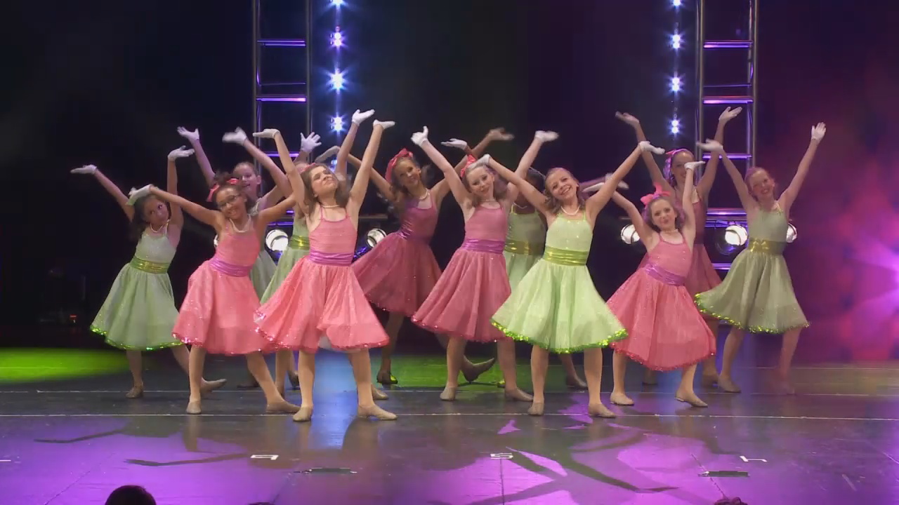

On another note, just so ya'lls can see, here is a frame grabs from the uncompressed resize.
Ever made a DVD using a widescreen DV file made from 1080p30?-uncompressed.jpg
