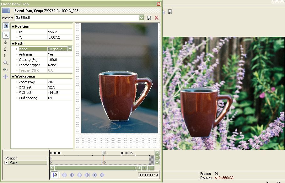

Attached are two print screens that illustrate two masks in one pan/crop window, where each mask has different attributes (that is, the attributes are not global). In the "MaskCup.jpg", the mask for the cup is selected, and shows it's "Mode" as "Positive". In "MaskHandle.jpg", the mask for the cup's handle is selected, and shows it's "Mode" as "Negative". Again, this is within the same pan/crop window.
I would suppose it's possible that this isn't possible in certain versions... I'm using Vegas Pro 8.0b, what are you using?

Andrew - thank you!
I just repeated the same process and I now DO get a Neg and Pos within one session. But when I posted, having repeated my "method", I didn't.
Now I can get neg within pos and pos within that neg too. It's as if something decided to "kick-in". This is far more straightforward, flexible, logical and more sensible than the approach I wrote.
Andrew, THANK you!!
