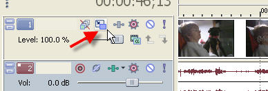

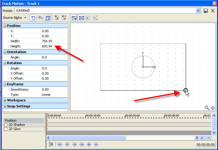

The slight additional pixels on either side will likely not matter a bit due to overscan, but if you are concerned, after you have edited the project, save the .veg file, import the veg into a new project, then use Track Motion and adjust the width and height of the project.
That should remove the few pixels on either side and dress up the video.
