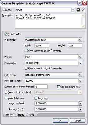

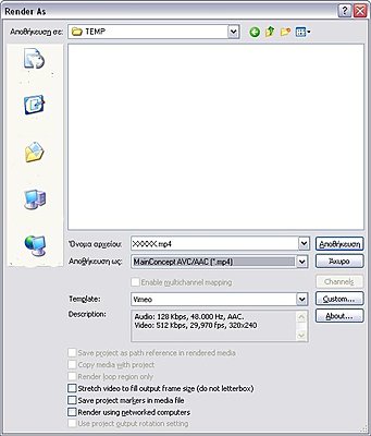

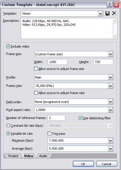

vimeo template
check my attachments or alternativelly check the link
Ultra Wide Aspect Ratio Tutorial (HV20/Sony Vegas) on Vimeo
the video on the link explains an ultra wide option of rendering but if you don't like it ignore everything else except the setting on the vimeo template but before he changes the height. Anyway it is the same as in my attachments.
hope this helps
