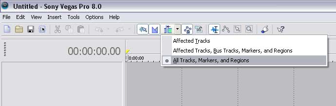

Auto Ripple
Hi Oliver, your answer is in the Auto Ripple function. There's a little icon that'll enable you to move all tracks, markers and regions together. I know how frustrating something like this can get, but I urge you to spend some time with Vegas to familiarize yourself with all the functions. I've always believed that Vegas works best when you know its full capacity and have customized it to your particular needs and requirements.
Nevertheless, I've attached a little picture to illustrate where the Auto Ripple drop-down functions are. Cheers.
