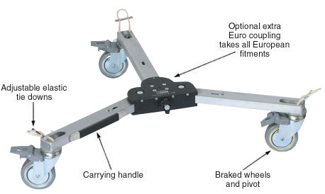

I've got a few shots which were filmed with a rolling spider (http://www.ronfordbaker.co.uk/images/spider_pic1.jpg). The floor wasn't completely even in places so you can see a bit of a shake at times when the wheels go in between tiles. Is there anyway to fix this? vegas or after effects?
