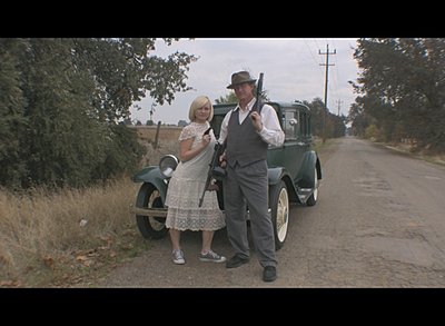

Originally Posted by Kevin Kimmell View Post
Richard: No, not pillar boxed.
Chris: You're closer but I'm not sure that's it. I think the end product would need to be in a 16:9 format. But are you saying I should start a 4:3 project and drag my 16:9 footage in and it should automatically put the black letterbox bars in?
Kevin, yes, that is what I was saying. However, Chuck is alos right. If you edit in 16:9, and produce a 16:9 file for DVD, most players will add letter box bars top and botton when outputting 4:3
However, at least until recently, we had to upload 4:3 to YouTube, or it would distort image.
This is a still capture from preview screen of an HDV file put on a 4:3 standard time line.
Can I "jimmy" 16:9 footage to look like 4:3 w/letterbox?-stillb-c.jpg
