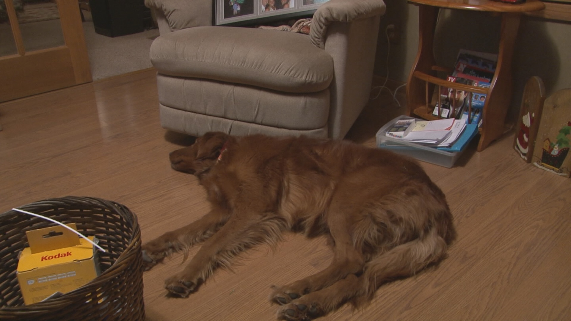

Compare grabs from two render methods
Tim provided a small file for me to play with. Not much motion in it to check out the judder issues. Would be nice to have one with a bit more motion.
I am uploading two frame grabs showing difference from rendering the Vegas time line to an intermediate Cineform .avi file, the other from doing a direct conversion in HDLink of the file sent by Tim. It looks to me like rendering out to 24p in Vegas loses resolution, suggesting that Vegas does not really perform a pulldown removal, like Cineform does, but you be the judge.
Need help with Vegas and FX1000 24p-vegasrendered.jpg   Need help with Vegas and FX1000 24p-cineformconvert.jpg
Chris J. Barcellos

I think the point there is that Vegas hasn't been updated to detect this camera's 24p, or it will have to be done with something like Cineform. In fact, I took Tim's clip, and converted it with Cineform, and it reported it as 24p after that in Vegas.
However, despite the fact that Vegas doesn't detect it, doesn't mean it is not there. You can still edit on a 29.97 time line.
Are you guys trying to add pull down in your renders ? That may be a problem.
