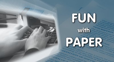

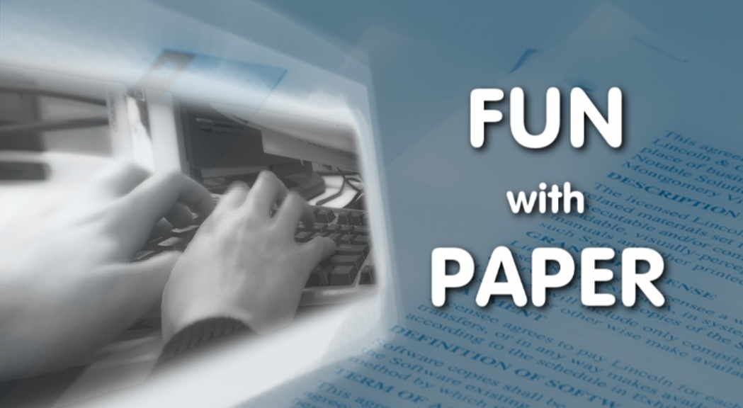

Of course - much easier, thanks Edward. Never thought of that, which is why I have been using what I thought was a clever workaround all this time!

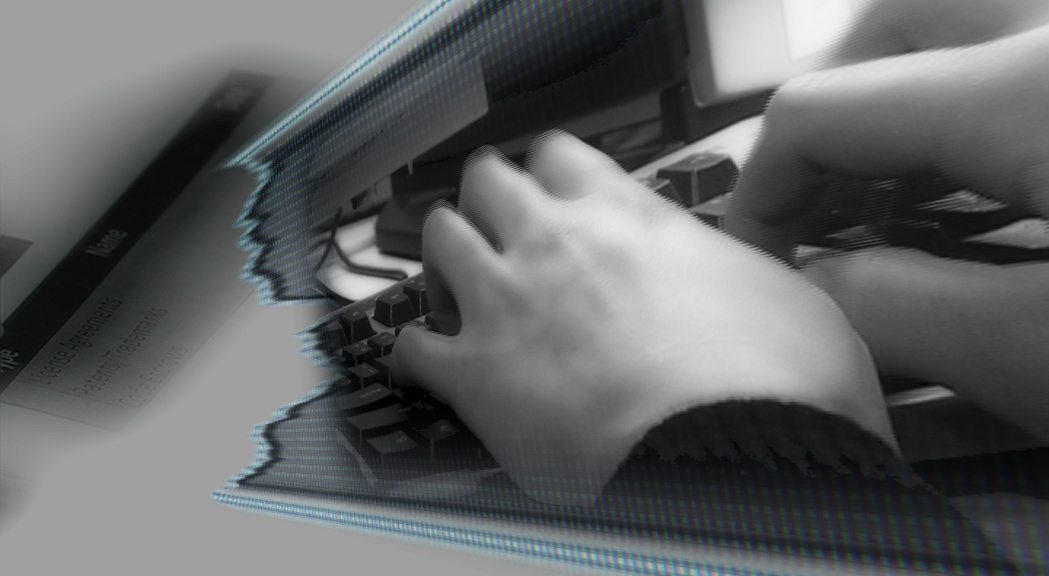

Having said that, I do like to customise my PinP shadows and glows rather than use the stock facilities all the time, as you will see from the two stills below (taken from the title segment of a project in progress - a lighthearted look at how my client makes such a mess of it's internal administration).
