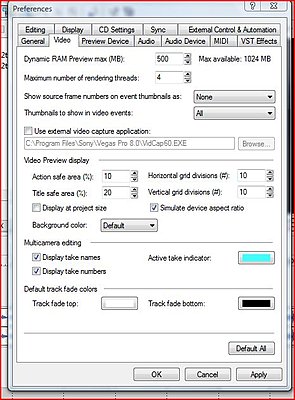

Hey Everyone, while gathering the system and settings info you requested I post I noticed that I am using 500 MB of 1024 available MB of RAM. Am I chasing my tail thinking that is my issue or? It just stuck out for some reason. I hope this helps you help me as this is frustrating to me so I know it is getting old with all of you. I apologize and definitely appreciate all the help. I have come to the opinion that my Vegas preview window will never have the same playback quality as watching my footage via an HDTV or watching it full screen on my PC. I hope the info below leads us some place. I have attached a screen shot of my settings in the video tab of prefferences, hope that was what you needed. Thanks again!
My PC system is as follows: My Dell PC Specs
Windows Vista 32 bit
Dell XP 420 with Intel Core 2 Quad CPU Q6700 @ 2.66 GHz x 2.66 GHz
4 GB Ram
Nvidia GeForce 8800 GTX Graphics Card
22” LCD Monitor using Spyder for calibration
Vegas Pro 8
Canon XH A1
Canon HV30 for playback and capture
www.socalt.com
Tim Cee is offline   Reply With Quote

That setting is for RAM renders. Which you don't seem to be doing, but are not a part of the problem you describe. But reading back through the thread carefully, I wanted to ask you this.
In your project properties. (File > Properties), is your pixel format 8-bit or 32-bit. If it's set at 8, change it to 32-bit and see if this improves what you see. It will have other ramifications, but I am curious about this.
-P

The RAM setting is mainly for RAM previews but is also used some in rendering. I've seen instances where setting the RAM number large would cause a render to fail while setting it to a low number would let it succeed. I do NOT recommend dropping it to 0, though.
As for the 8-bit setting vs the 32-bit setting, the 8-bit setting is the default and will definitely be FASTER than the 32-bit setting.
