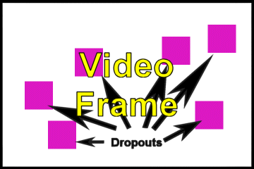

I was using friend’s computer with the latest Vegas Pro, when viewing certain video files (NTSC SD, XDCAM) the preview window showed a lot of dropouts in them. I could go back and forth in the file, come back to these frames and the dropouts were there. Yet when viewing the same files in other NLE the exact frames were just fine. In all cases I was using the same source, USB external drive. Any thoughts why?

No, when I say dropouts I don’t mean framerate. I mean dropouts like attached at the bottom.
I see the dropouts when paused, so the CPU horsepower has nothing to do with it.
Honestly, I don’t see any logical explanation, though I was hoping for one.

If you are talking about XDCAM (DVCAM-mode) with Vegas Pro 8.0c, there is a significant bug that can cause what you describe. It also causes your audio to go away if you have a clip longer than 17 minutes 40 seconds.
SCS has two dlls that can fix the problem. Otherwise, you need to go back to Vegas Pro 8.0b for XDCAM (DVCAM-mode) to work right.

The specific dlls that need to be replaced by new ones from SCS are the following two:
mxfplug.dll
smdkwrap.dll
With the fixed version of these two dlls replacing the original ones in Vegas Pro 8.0c, both XDCAM SD (DVCAM-mode) and XDCAM HD work fine, I've been using the replacement dlls for months with both formats.
