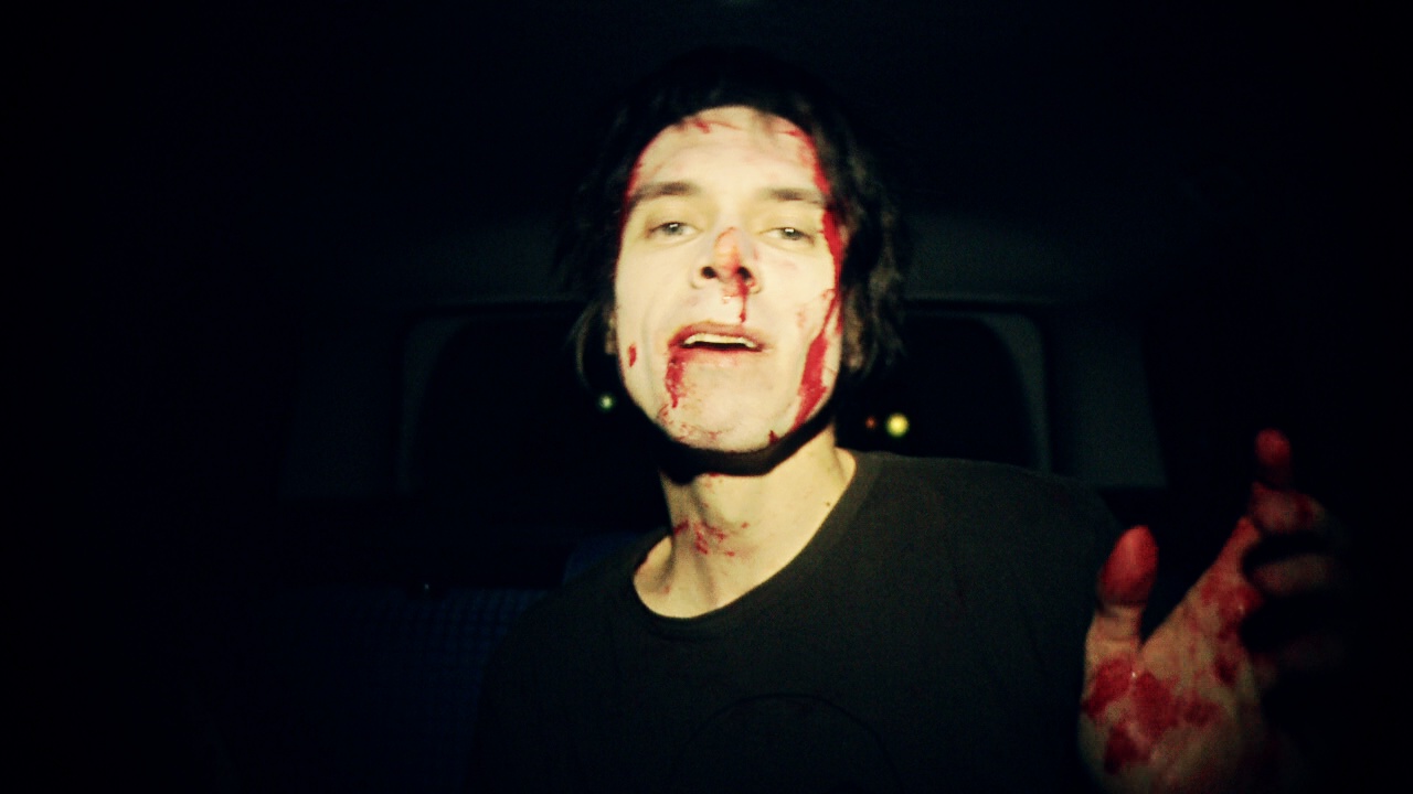

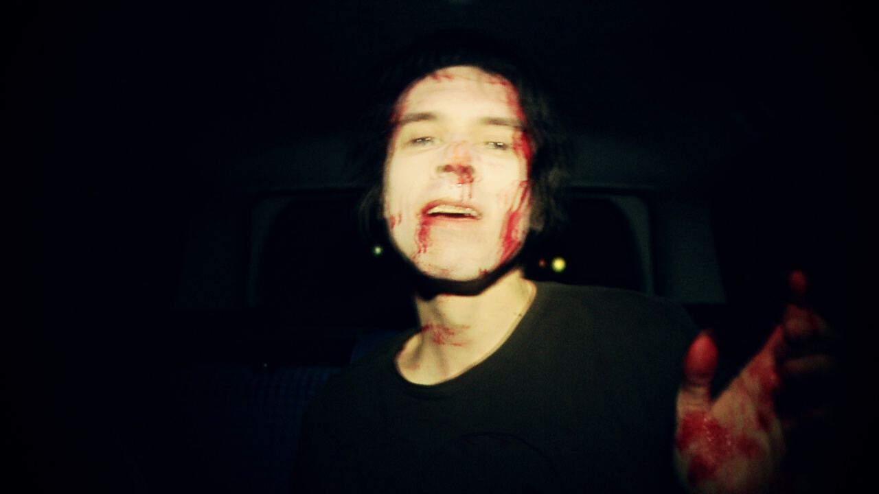

Hi,
Ok this is shot 50fps and sped up to 200% on vegas timeline (this I did cause theres some slow motion playback at the end where the footage is slowed down to 50fps).
But, Im seeing this weird ghosting or motion blur. It looks pretty liek pretty normal motion blur that you get when you pan, just on a heavy side. Funny thing however is that when I have vegas preview set to preview auto its not there, good or higher its there and of course when I render.
If I go through the video frame by frame with preview set to preview auto that "double image" or "ghosting" is not there. If I go frame by frame in good or higher quality its there.
Im guessing its just normal motion blur but just wanted to double check!
Sami
Ghosting, is this normal motion blur?-vegas_preview_auto.jpg   Ghosting, is this normal motion blur?-vegas_good_auto.jpg
Sami Sanpakkila is offline   Reply With Quote

I shot it 720/25 overcranked to 50fps.
OK! I found out whats causing it! Its the fact that its shot 50fps and then sped up with a velocity envelope to 200% (making it 25fps). Thats causing it.
How do I make a 50fps into 25fps so that this doesnt happen? Why does it happen? Is it possible that vegas handles all the velocity changes as interlaced?
Sami

I tried setting the project settings to different frame rates and all yield slightly different looking results, interesting is that when I put 20 or 22fps as project speed it looks fantastic, no ghosting whatsoever.

Hi Seth
Thank you very much for the advice. My footage is from an EX1 camera shot at 720p at 25fps overcranked at 50fps. No intermediate file, mp4 file rewrapped to mxf and dropped on the vegas 8.0c timeline.
Just taking a quick look and I think at least one of the culprits is that when I set the velocity envelope to 200% (with my mouse) and although it reads 200% when I went to the key frame and chose "set to" it suddenly read 199%. Setting it to 200% by typing in the numbers AND choosing 50fps as the project fps I dont see the artifacts anymore on the timeline.
Problem now is that trying to render it to any 25fps file the artifacts appear again.
Oh boy, this might be a tough nut to crack :(
...OK! tried changing media properties from the timeline and checked "disable resample" AND SUCCESS!!!! YES!!! It looks and works perfect!! :D
Oh and also now I can have the project properties at 25fps and it still looks good! :D
HAPPYYYY!!!! thanks everyone! :D
