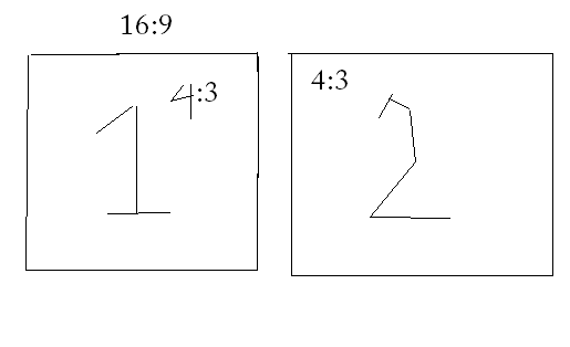

I've just shot a theatre show in HDV. The show took place in 2 locations in the theatre.
I filmed 2 consecutive shows with locked off frames for each of the locations. I shot it wide so the sides of the frame were empty, with the intention of cropping it to 4:3 size and split screening the footage from each location. I'm not quite sure how to crop the 16:9 to 4:3 in
vegas while retaining the ability to split screen. I've tried cropping but it gives me black bars on each vertical side of the new 4:3 image, but, when I try to lay both images side to side, these black bars overlap. Should I render each out lossless as 4:3 then lay them on a 16:9 solid colour, could I use the cookie cutter, or should I use after effects to achieve this(which I have access to but am unfamiliar with)?

My final output is 16:9, but I want each of the two resized boxes in the 16:9 master frame to be squarish. I'm not too concerned if they're 4:3 exactly.

OK, now I understand.
Change the project properties to 4:3 and do the "Match Aspect" part. Then change the project back to widescreen.
Now use Pan/Crop to crop as desired.
Next use Track Motion to resize and position the PIP.
