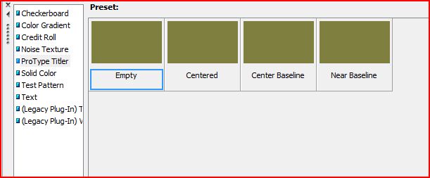

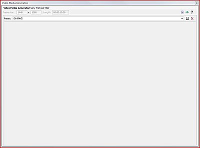

Any ideas why my ProType Titler isn't working anymore? It shows the boxes to select the event to drag to the time line but once it's on the time line all I get are red frames. Then when I go to edit the text in the title I get a blank box. I've attached a couple of screen captures of what I get. Please help!

sounds like you either need to try to do a reset when opening vegas (holding shift and ctrl keys and opening vegas) or do a repair/reinstall of Vegas.

I tried the reset and I've already reinstalled twice but no change. I'm using 8.0c with Vista. The maddening thing is it was working up until a few days ago.
Any other suggestions??

Do a system restore back to when it was working. Also determine what has changed on your system since then.
