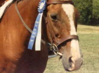

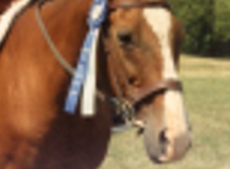

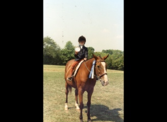

Yeah, the right-click and "Match Output Aspect" is what I'm talking about. Here's some examples to show you the difference between the three:
Image 1: The original image simply dropped onto the timeline
Image 2: Using Pan/Crop - set the "Match Output Aspect" - and zoomed in on the horse's head.
Image 3: Using Track Motion to zoom in on the horse's head
I believe you'll immediate see the difference between these two zooms.

Wow, what a difference. Nuff said. I have gone back and changed almost all of the images to Pan/Crop even though I loathed to do it. I am not zooming in that much, but I would prefer to have it look crisp - I will only use motion for movements.

I zoomed way in to somewhat exaggerate the difference. However, there may certainly be times you WANT to zoom in that far.
I'm a big fan of using the tools for what they were designed to do: Pan/Crop for panning and cropping (i.e. zooming IN on the images) and Track Motion for positioning/creating PIPs (essentially zooming OUT).
