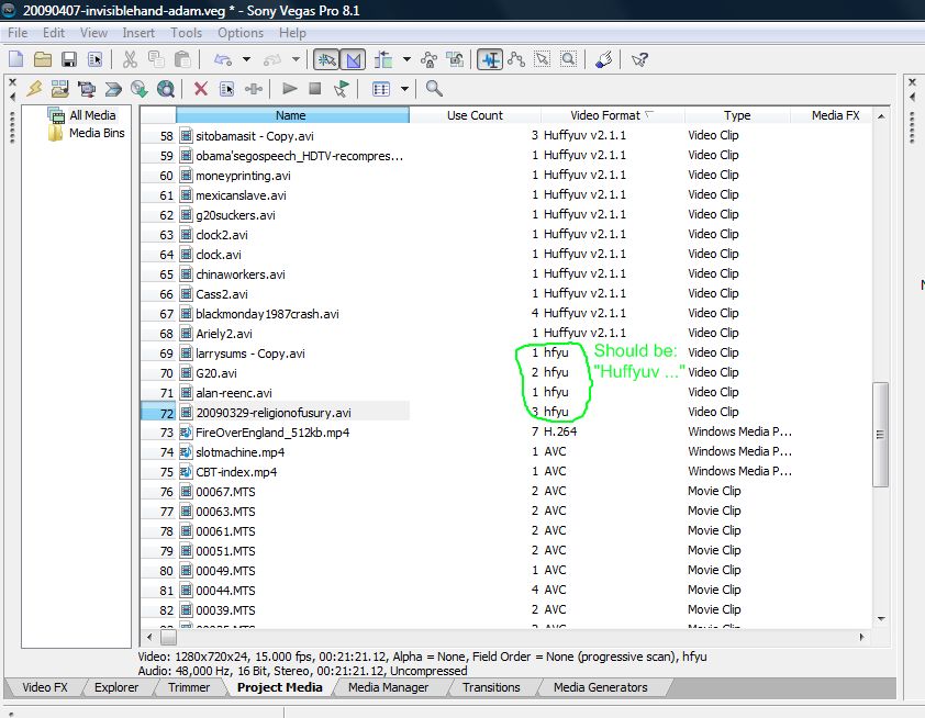

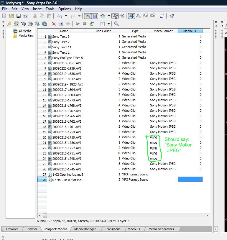

Hi, I just sent this message to sony support, and I'm waiting to get a decent reply from them... Can you guys help me? I searched the forums a bit, but couldnt find anything specific to this issue...
Greetings, I have a very technical question here, which may not be a fault of Vegas (8.1), per se, but I wanted to know if this was a bug and if there is a workaround.
This issue also pertains to Vegas 8.0c, and 8.0c seems to do a better job at masking the issue.
Issue is as follows:
I understand that Vegas uses the VFW interface for handling AVI files. I am very experienced with dealing with VFW codecs, and my workflow works fine with both 8.0 and 8.1 with regards to VFW codecs.
Basically, it appears to be a limitation on the amount of times that a VFW codec can be called in both Vegas 8.0 and 8.1. If i import 20 AVI files, all of the same exact video codec, not all of them will function properly on the timeline at once. Only about 12-16 of the avi's (of the same codec) seem to work properly at once. Vegas 8.0 seems to be better at masking this fact, because if I play the timeline through on 8.0, all of my avi clips tend to playback properly, but on 8.1, I notice that some .avi's will have blank playback in the preview window.
The only workaround for making the entire project render properly (not only are the clips black on the preview window, but are blank if i try to render the project) is to split the project into parts and render that way. I have not nailed down an exact number, but I can only seem to have 12-16 avi files of the same codec opened at once.
Attached are 2 jpgs which should help clarify my issue. Please, where is the issue located? Is this a limitation of the VFW interface, Vegas or the particular VFW Codec?
In the two pictures you can see the issue I am describing. In vegas 8.0, if I locate an avi that does not show up properly in the project media window, and "select timeline events", those events in the timeline TEND to play back fine.
In vegas 8.1 it is much worse, i do the same thing, with the same exact project and "select timeline events," the video will not play back in the preview window, or if it does, it will drop random frames.
Please help. This occurs with both sony avi codecs (one of them was the sony mjpeg codec), and 3rd party codecs (XVID and HUFFYUV).

Forgot attachments...
Technical question about AVI files and Vegas-vegas1.jpg   Technical question about AVI files and Vegas-vegas2.jpg
