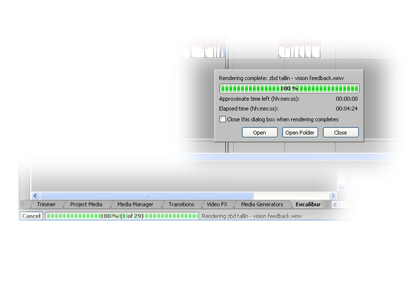

Meanwhile, here's a picture showing exactly what happens. The (1 of 29) display in the status bar increments from (1 of 1) to (1 of 2) etc etc. The only way to get out of it is to force Vegas to close using Task Manager. Only one file is actually rendered (perfectly) and there does not seem to be additional disk or processor activity. Weird . . .

Yes Ian, take out that stick! Sounds like you might be closing in on this.
Also, have you tried checking the close this window box?

Yeah, fingers crossed! And yes, I have tried clicking on everything clickable, to no avail.
