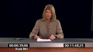

Next step - a proxy with burnt-in TC window. As Perrone said, it's fast to edit with. The TC window means that the Tel Aviv edit becomes an irrevocable record of the edit decisions. It is rock solid, not subject to formatting, translation, 3rd party software, or any other possible sources of error.
I'd add to P's workflow and suggest that the proxy edit be output (with that TC visible).
What can be done with this is that it can go on a lower video track in FCP. The Lodz editor has all previous edit decisions, with timecode referencing the DNxHD master, up on the screen. This is a very solid reference to the Tel Aviv edit.

Yes, certainly LEAVE the timecode window intact on the proxy so you have a frame accurate master to work with. Don't worry about the transitions and so forth at this point. You can assemble those in FCP.

On the preview window, click the "+" button, (Video Output FX). Select Sony Timecode. Select a font, size and location. That's it.

Per Perrone, the new master TC can be applied to the preview window, this is "Project-level" efx.
You need this - do it. And yes, it replaces original camera TC.
However, if you have production notes, logs, whatever that are keyed to your original camera TC, you can capture that in your proxy file(s) as another TC window as well.
Vegas offers the opportunity to add efx (including TC window) at several levels.
5. Project
4. Bus
3. Track
2. Event
1. Media
In the case of the TC effect, application at Project, Bus, or Track level will all match TC to the timeline. Application at Event level will start TC at the beginning of the clip, as present on the timeline.
If you right-click on the clip in the Project Media bin, select Media FX, you'll be applying such fx at the Media level - this will track with original camera TC, whenevever the clip is used in the project.
(Media-level efx can also be accessed from timeline events by right-clicking and selecting Media FX, not Event FX)
Check out this example. On the left, camera TC, with a reel number dropped in with simple text. On the right, timeline TC (for your project - the new master TC).
