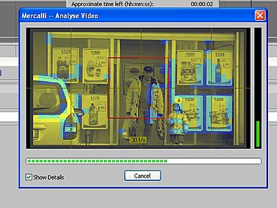

Not aware of anything Thomas, although you would think that with stabiliser plugins such as Mercalli available for Vegas the capability to track moving points across time is certainly there.
The challenge goes out to the plugin developers!

When I view Mercali working, it analyzes Full Frames and compares FramePosition1 to FramePostion2 and then FramePositionN. Added to which Mercali has this option to weight the analysis to the centre of the frame or to the border. I don't see a grid of points being employed? My other deshake s/w does something similar.
My thoughts are that there would be a need for developers to be able to get at the underlying code to augment a meshing together of "points"?
Grazie

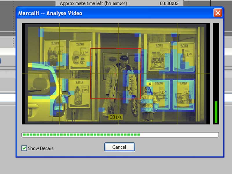

Of course I'm not suggesting Mercalli will do the job as is. My point is that the technology exists to identify areas of a Vegas frame (see printscreen) and therefore that *concept* could be applied to the issue of tracking. As far as I can see, Mercalli analyses PARTS of a frame and compares those parts to the same shapes in the next frame to determine their relative position and adjust accordingly. Surely that's what motion tracking is? After Effects uses the same engine for stabilisation as it does for motion tracking. And tracking doesn't have to be based on points anyway - Mocha, for instance, is a planar tracker, where the user defines an area or plane to be tracked.
