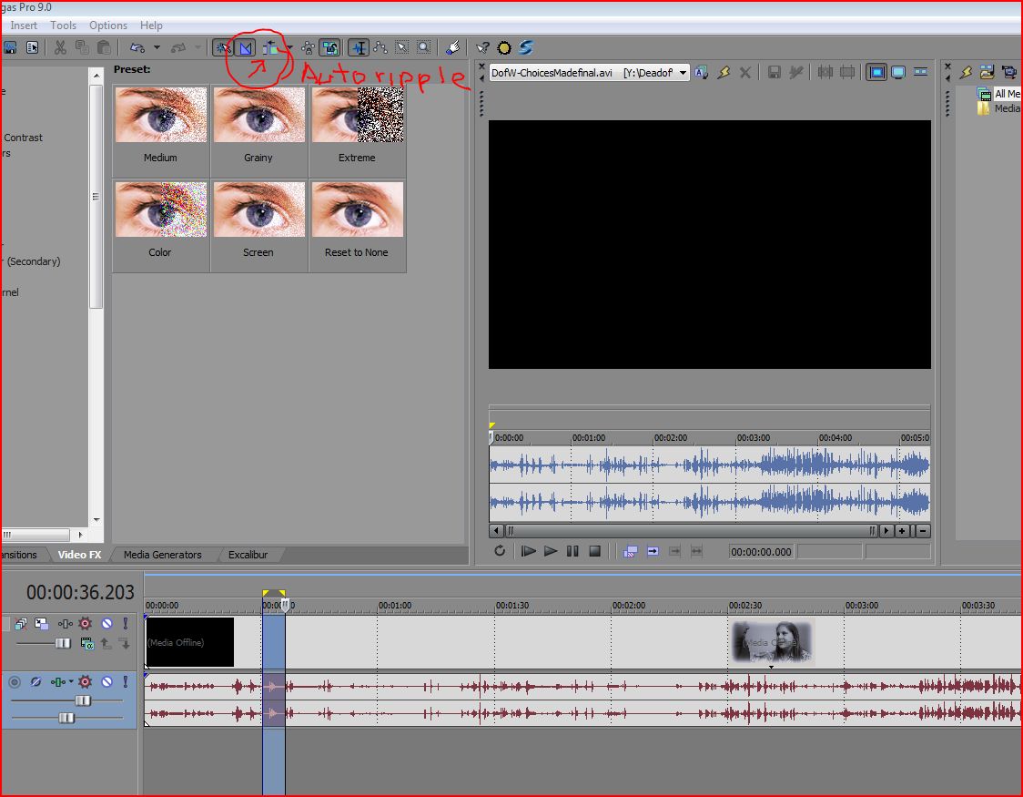

Use the auto ripple tool. There are different setting for it. Here is picture of button for Vegas 9, which is similar to Vegas 8.

Actually its as easy as toggling on auto ripple then inserting the new clip on the timeline where you want it. Everything from that point on will automatically move to allow the new clip to fit. You can choose to apply auto-ripple to all tracks or just the affected one. Just make sure you remember to turn auto-ripple off again (unless you always work with it on)
