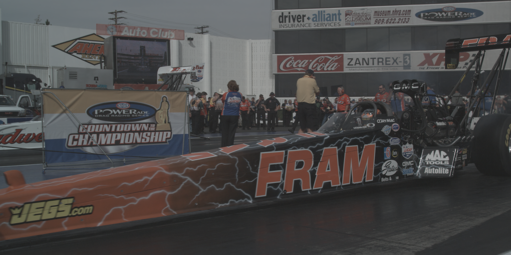

Ok, so here's an example.
I took 2 frames of a RED 4k file and laid it onto a timeline. I conformed that timeline to 1024x512 to preserve the 2:1 layout of the original. I took a frameshot of that 1024x512 file. I then went back to a 4k timeline, rendered that 4k RED file to a 4k uncompressed AVI file. Pulled that into virtualdub, did a lanczos resize to 720x360, and rendered back out uncompressed. Put that onto a 720x360 timeline, and took another frameshot.
So here, we have an SD sized frame derived from a 4k source. This site won't let you upload a real HD sized image, so I had to pass on that.
Look at the clean edges on the signs in the background and the engine. The clean edges of the lines on the car. All those problematic things people say you can't get on a downscale from HD. If coming down from HD was a problem, then coming down from 4k should be terrible. Judge for yourself.
There is a color space shift that happened that I didn't bother to correct for. Sorry. Other than that, this photo got zero processing. Just laid on the timeline and a frame shot taken.
Maximizing HD to SD Quality-drag_orig2_000000.png   Maximizing HD to SD Quality-drag_sd.png
