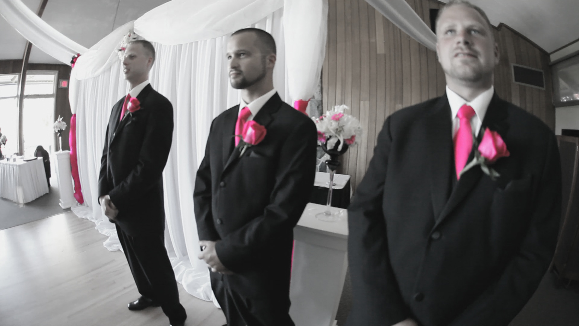

Old August 28th, 2009, 05:53 PM   #6
Posts: 1,200
Jacques,
Here's a still from the Vegas timeline. This was done quickly with the secondary color corrector in Vegas. Tacky? Perhaps, but most couples in my market (weddings) seem to like it.

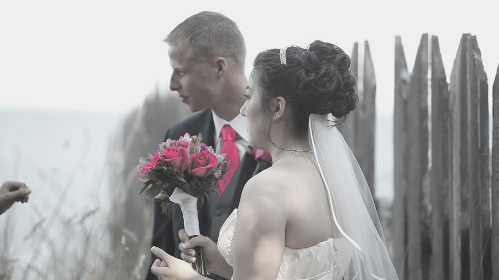

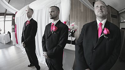

Old August 29th, 2009, 11:57 AM   #8
Posts: 1,200

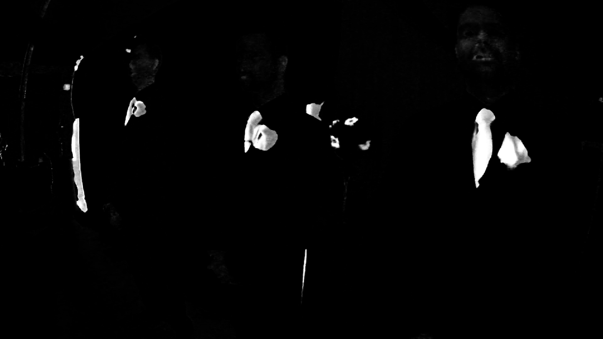

Having the subject evenly lit will make the color easier to pull. if you want to make it easy to highlight (focus) you subject, then have them wear a standout color (say... a red vest or if the door is red). Or if the door is a uniquely brighter color. The trick is the color that you use will be unique in the shot, because when you pull it using the secondary CC, it will pull all occurrences of that color in the shot. I don't know if you can edit the mask in secondary CC (it would be nice), other than tweaking the settings a little.
Here is a still of another Secondary CC color isolation and the mask that is created by it.
In the first shot off to the left there is an exit sign that is caught in the color effect, I'd rather not have this there. In fact, ideally I'd just like the ties and flowers to be highlighted.
Isolating colour in Vegas?-pink2.jpg   Isolating colour in Vegas?-pink2-mask2.jpg
