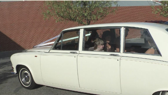

Just for interest does the pattern on this portion of my clip (pic is below) have anything to do with the fields??? If I do a frame capture it's not there!!! but it appears in the rendered video if you leave the offending bit in (I cut it out) Ideas what causes it????
Chris
