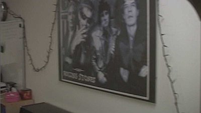

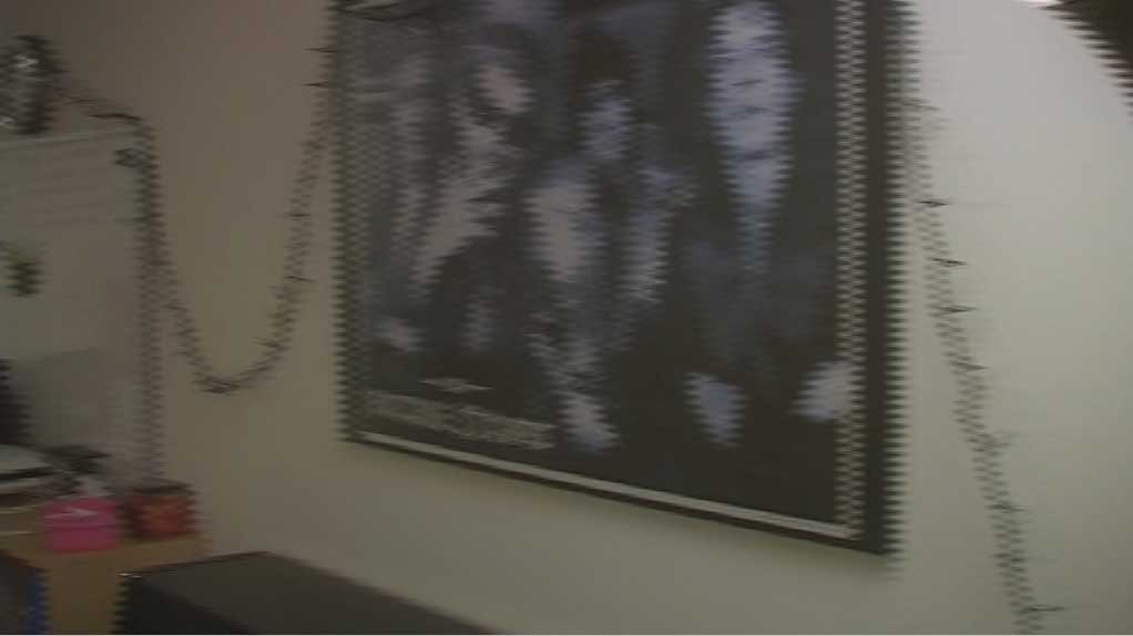

Don't worry, you're not raining on my parade :) But what I'm getting is definitely NOT just some more artifacts because of zooming. When there's no movement, everythings fine, but when there's movement, the image looks terrible (see attachment: interlaced.jpg) The only thing I have to change to fix this, is NOT to do "stretch to fill frame" I just have to make it letterbox, so really depends on wether I use the "stretch to fill frame" option or not.
Adobe premiere Pro 2.0 is not having this problem stretching the video to anamorphic: See interlaced_good.jpg So it can be done correctly! And yes, it's NOT that adobe premiere is de-interlacing. It really outputs interlaced video that looks good ánd smooth. Furthermore I make sure I choose "lower field first and interlaced" when outputting to MPEG2, so it really isn't about setting the wrong field order or something like that....
Vegas video 7 is just doing something wrong with the interlaced lines when stretching to anamorphic 16x9... Nobody else encountered this???

Thnx for the explanation. Unfortunately, your description doesn't work for 25i. (I tried)
It seems Vegas just stretches the video no matter what, without taking care of the interlaced lines. The jitter I'm getting also looks like bigger interlaced lines, which is totally logical...
It seems I'm now stuck with Adobe Premiere 2, since that one does appear to take care of the interlaced lines while stretching...
I really like Vegas, but it's quite stupid that such an advanced video editting application doesn't seem to be able to resize interlaced video...

Hmmm.... tonight I will do some testing myself with 25i footage.
Are you sure Premiere isn't de-interlacing the footage during/before changing the aspect ratio?
And have you checked your converted Vegas footage on a normal tv (as computerscreens often have a problem playback interlaced footage correctly?)

Well, something's up here, but I doubt that there's a bug in this one...
Vegas deinterlaces any footage that's going to see a frame-rate/size conversion for a given render (in "good" or "best" rendering modes). Of course, when it's generating interlaced footage, it interlaces output.
The simplest way to think of this is to think of input and output fields as frames. Your 50i footage can be thought of as 50 fields per second. When Vegas makes 50i output, it can actually render 50 frames per second (if the processing chain calls for it) and pull the appropriate field data from that frame information.
Also, if you are dropping these files back into Vegas to preview, preview-quality viewing can show some pretty strange scaling artifacts with interlaced footage. We do this for performance. Preview quality is definitely not intended for final output.
