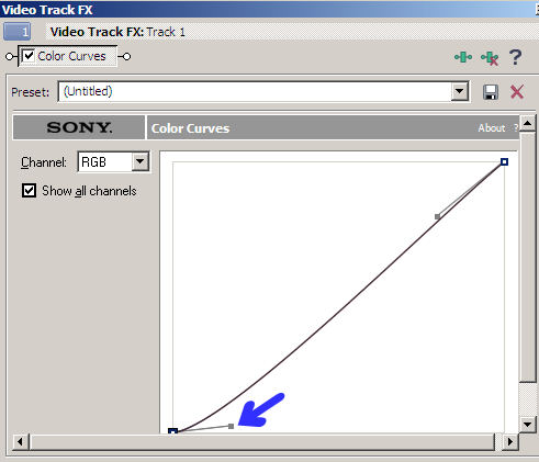

That's probably the black restore filter. It has its uses, such as making sure that dark greys really are black, but, when using it to crush blacks it can look bad. "Bad" meaning that you have a sort of banding effect where something that should be smooth abruptly transitions from dark to black. Hard to describe, but you'll know it when you see it.
Much more useful for crushing blacks is the Sony Color Curves filter. Grab the handle that's indicated by the blue arrow and move it down and around - voila, you're crushing the blacks. The waveform scope is very handy to help you figure out what range you're pushing down into black.
