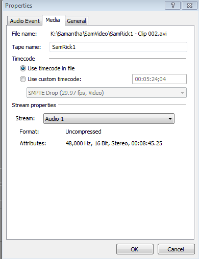

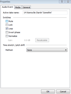

As you can see from the below images, something is seriously amiss.
The Wanna be starting something is pointing at a video tape clip, which is very wrong. Note that the "14 Wanna Be Startin' Somethin'" does not even exist any more (I deleted it and replaced it with a .wav file under a new name) but is referred to in the properties window as the active take name, and even stranger when you move over to the Media tab the file name refers to a video clip. And yes I cleaned out project media. 14Wanna be Startin' Somethin' does not even appear in project media window, which makes it even weirder.
