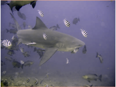

I've been patiently trying to learn how to use the colour correction fx in Vegas Pro 9 to no avail.
I've spent hours of trial and error as well as following this tutorial on correcting white balance Fixing Incorrect White Balance using Sony Vegas but I can't get the video anywhere near the same as I can in photoshop.
In photoshop using a screen grab, I can get the colours almost perfect by using the channel mixer, and then by setting the levels and adjusting exposure in under 60 seconds. I basically use the channel mixer to build the red channel by copying pixels from the green channel, reducing the blue channel and then setting the levels.
Example below:
http://www.alexasigno.co.uk/shark-video-test.jpg
Does anyone have any special techniques or advice they could give on how to correct under water video footage in Vegas?
Cheers and thanks in advance.
Alex

Ok, the quick and dirty way is this...
1. Open Color Corrector (3-wheel color)
2. Select the "-" eye dropper under the "LOW" wheel, aim it at something black in the preview window, and click. That will bring the black more in line
3. Select the "-" eye dropper under the "HIGH" wheel and aim it at something white. This will bring the highs in line
4. Do the same for the middle wheel and aim it at something mid-gray. This will get you a basic color balance. Tweak from there.
You can also do something similar to what you've been doing in photoshop by using the "color levels" FX instead of the color correction.

Hey Alex, I was somewhat saddened to see your underwater PS color correction, because its so much better than anything I have been able to do in Vegas - With underwater stuff I generally have been satisfied CC mainly boosting the reds - for a really quick result the auto color levels filter full color correction with film levels preset has also sometimes looked OK. Until now. If you do manage to achieve the same result in Vegas as you have in PS I would be really pleased to know how you did it. Otherwise, I think you are going to be saving your footage as JPEGS and batch processing in PS.

Come on guys...
This took 10 minutes...
This one slightly longer because of some tricky issues... (and this was 2 years ago when I was just learning how to correct)

Hi Perrone, yes, its easy quickly to get good results correcting underwater video, even very good results, and probably most people who do a bit of underwater video have a few presets saved for various depths and conditions. But Alex has got an excellent result. I had a quick try CCing the raw side of his posted sample, enough to see I couldn't get near the result he got from PS. Hopefully this was just because the sample was a JPEG and there isn't enough color info to work on. If you can duplicate his result in Vegas we'd probably both be interested in the settings.

Ok, here's my result after 5 minutes...
I could probably do better fooling with the original footage rather than a low-res JPG image.. But I don't think it's too bad.

Thanks for the replies guys, Perrone you've managed a great job at correcting the footage. However I just can't get anywhere near it, what is the process you used to correct the footage?
I've tried using the colour corrector and levels FX but I just can't get anywhere near the right colours using these. In photoshop setting the levels is easy as you get to see a histogram of the levels by channel rather than having to just guess the start and end points :-(

First correct the white balance. I use a plug-in called AAV Color Lab. Once that is done, I use the color wheels to fix the rest. Use the negative eye dropper on the high and middle wheels. Then do the low wheel. Do you know how to correct with the wheels?
You can turn on the histogram per color in Vegas too. Not sure that would be how I wanted to work, but if that's what your comfortable with, you can do it.
